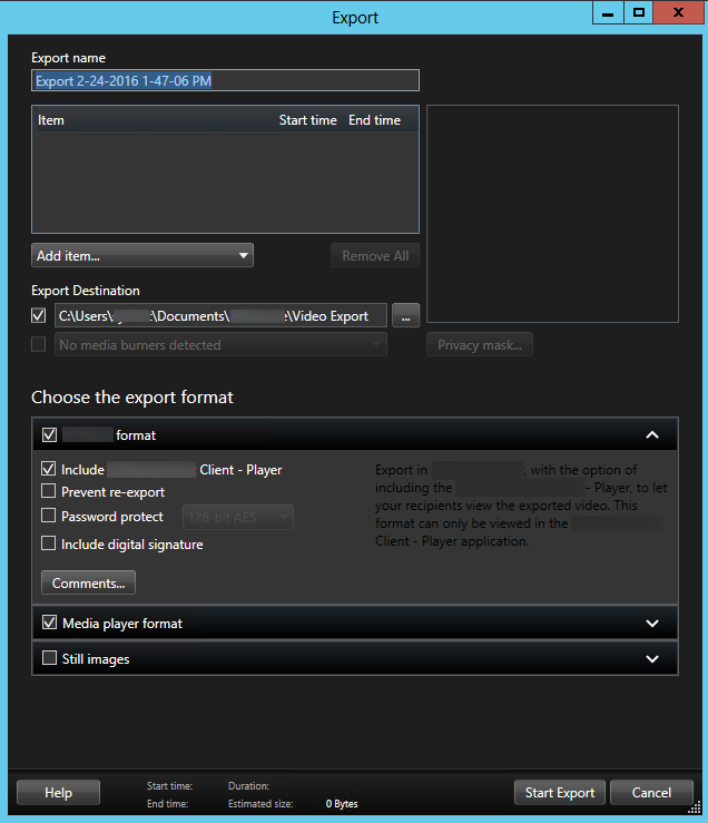

- In the Export name field, enter a name for the export. The system automatically creates a name with the current date and time. You can change the name.
- Specify a path, a media burner, or both, for the destination of the export.
- Click the relevant tab to select one or more of the following formats to export to:
- XProtect format - use the XProtect database format, with the option to include the XProtect Smart Client – Player along with the export. If you choose this option, other media players will not work
- Media player format - use a format that most media players can play. This requires that a media player is installed on the computer where the export is to be viewed
- Still images - export a still image file for each frame for the selected period
- If you want the receiver to be able to verify that the exported evidence has not been tampered with, select the following check boxes:
- XProtect format
Include digital signature
This will enable the Verify Signatures button in the XProtect Smart Client – Player.
- Click Start Export to export your evidence.
For information about the settings for the format you selected, see Export window settings.

Name |
Description |
| Export name |
The program automatically fills this in with the local date and time, but you can rename it. |
| Item |
Lists the items selected for export, for example video sequences. For each item, you can change the timespan by clicking the start time or the end time. After selecting a new date and time, click Go To. You can also change the timespan by dragging the handles underneath the preview area. Click an item to see a preview of the export clip in the preview area. To preview multiple items simultaneously, press and hold down the SHIFT or CTRL buttons while clicking the relevant items. You can delete an item from the Item list by clicking the red x next to it. The red x appears when you hover over the item with your mouse. If you want to split the item into two, click the Split icon in the preview area. |
| Add item |
Use the Add item button to select other items that you want to include in the export. Use the Remove All button to clear the list in the Item window. |
| Export destination |
Path - when you specify a path, the folders you specify do not have to be existing ones. If they do not already exist, they are created automatically. A path may already be suggested in this field. Media burner - you can specify a burner that you want to send the export to. In this way, you create the export and make sure it is written directly to an optical media in one go. |
| Privacy mask |
Click to add privacy masks to the video. The privacy masks cover the selected area with a solid, black area. The privacy masks that you add here only apply to the current export and for the selected video. The export may already include video with privacy masks configured by your system administrator. For more information, see Privacy masking (explained). |

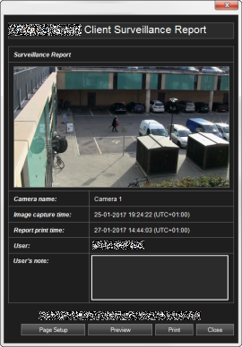

Print report from single cameras
You can print single still images and related information from live cameras or from recorded video. Notes that you add are also printed.
- To print a recorded still image, go to the Playback tab.
- To print a live still image, go to the Live tab.
- Open the view that contains the camera you are interested in.
Hover over the view item. The camera toolbar appears.
Click the
icon. A window appears. - Add notes if required.
- Click Print. The Windows Print dialog appears.
- If necessary, change the print settings and print. Otherwise, just click Print.
