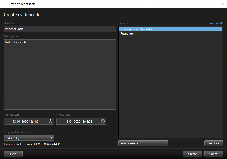

                                            To the right of the timeline, click Evidence Lock > Create. A window appears.
- Give the evidence lock a headline and, optionally, a description.
- For information about the remaining fields, see Evidence lock settings.
- Click Create. If the evidence lock was created successfully, you can click Details to see what went well and what did not. See Evidence lock status messages.
| Name | Description |
| Headline | The headline of the evidence lock. |
| Description | A description of the evidence lock. |
| Interval start | Adjust the start date and time for the video sequences you want to protect. |
| Interval end | Adjust the end date and time for the video sequences you want to protect. |
| Keep evidence lock for | Specify for how long you want to keep the evidence protected. Depending on you user rights, you can have the following options: hour(s), day(s), week(s), month(s), year(s), indefinite or user-defined. If you select User-defined, click the calendar button to select a date and then adjust the time manually. When done, the date and time for when the evidence lock expires is shown. |
| Select camera | Click to select more cameras to include in the evidence lock. |
| Remove/Remove All | Click to remove one selected camera or all cameras from the evidence lock. |
