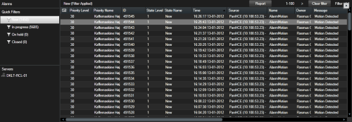

The Alarm List displays incoming alarms by default, with the most recent alarms at the top of the list. Alternatively, the alarm list can display a list of MIPClosedShort for "Milestone Integration Platform". plug-in and analytic events, for example, access control or license plate recognition.
Alarms or events with associated video are displayed with an icon . To preview a still image from the time of the alarm or event, hover over the icon. To preview recorded video from the camera or cameras associated with the alarm or event, select the alarm or event in the list. To stop a repeating alarm sound, select the alarm associated with the sound in the list.
You can decide how you want the list to appear, you can filter the columns, you can drag the columns to different positions, and you can right-click to show or hide certain columns.
The event list does not display system- or user-generated events, such as motion detection or archive failure.
The list is updated every 3 seconds.
To see a list of events, enter setup mode and select Event in the Properties pane. See also Alarm list settings.

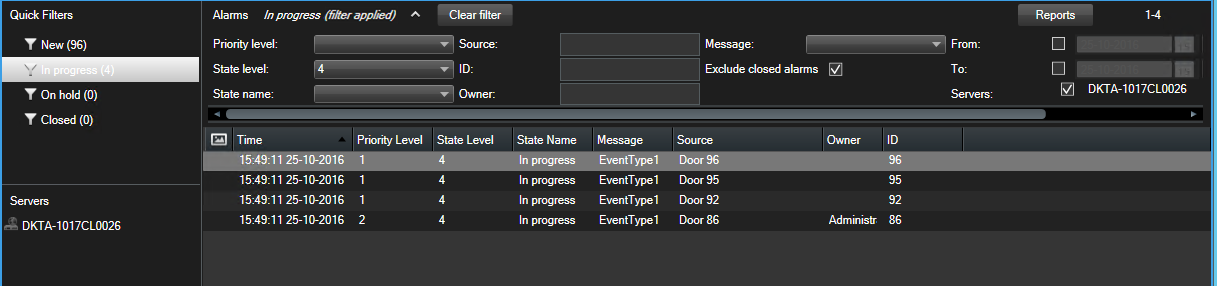

Filter alarms
There are several ways you can filter the alarm list, so it displays just the alarms or events that you are interested in.
Steps:
  1. In the toolbar of the alarm list, click the Custom (filter applied) or No filter text. The text may differ depending on the filter selected.
  2. Enter filter criteria on any of the columns you want to filter on. For example, if you enter a user ID in the ID field, the list will only display alarms assigned to that particular user.
  3. You can combine filters, for example State name and Owner (assigned to).
  4. To return to the unfiltered alarm list, click the Clear filter button.
  5. To sort the content of the alarm list, in the alarm list, click the title of the column.

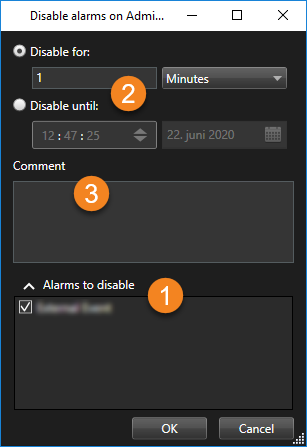

Disable all new alarms on selected event types
If an event is triggering false alarms, you may want to disable all new alarms on this type of event for a period. For example, if there is a lot of movement around a camera and this is causing several false alarms, you can disable alarms on motion detection for this camera for 10 minutes. This helps you see the real alarms that you need to pay attention to.
You can disable all new alarms using the Alarm Manager or a map.
  1. Using the Alarm Manager: in the alarm list, right-click an alarm and select Disable all new alarms.
    Using a map: right-click an alarm and select Disable all new alarms > Disable.
    The Disable all new alarms window appears.
  2. In the Disable all new alarms triggered by list , specify which types of events to disable alarms on.
  3. Specify until when or for how long you want to disable alarms on the selected event types .
  4. Optionally, add a comment about why you are disabling alarms on the selected event types .

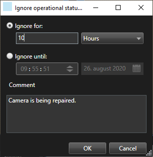

Ignore alarms on maps
On a map, you can ignore an alarm for an element for a duration of time. For example, if a camera is being repaired and therefore disconnected, you might want to ignore the error showing up on the map during the repair. When you ignore an alarm on a map, this does not remove the alarm from the alarm list, just the map.
