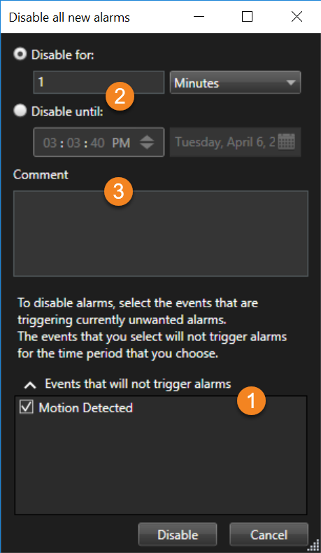

    The Disable all new alarms window appears.
    Disable alarms based on event types in XProtect Smart Client.
  2. In the Events that will not trigger alarms list , select which event types should not trigger alarms.
  3. Specify until when or for how long the selected event types should not trigger alarms .
  4. Optionally, add a comment about why you are disabling alarms on the selected event types .
If you right-click an event, an overview of disabled events appears, and you can see which event is disabled and what the time-out of that event is.
