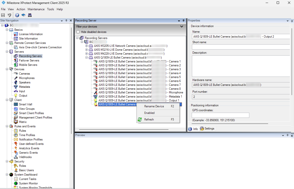

Result after updating hardware
Version1.1.21
LanguageEnglish
After the update:
  • Newly configured output ports appear under Recording Servers → Cameras → Output
  • Existing camera settings (video, recording, rules) are preserved
  • The new relay outputs can be managed and used in Rules and Events
Newly detected outputs are disabled by default. After updating the hardware, uncheck Hide disabled devices, locate the new output, and enable it before using it in rules or manual control.
