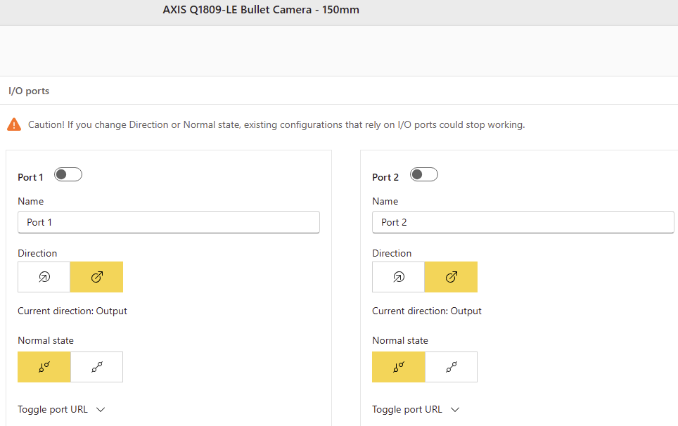

Some Axis cameras support configurable I/O ports, where a port can be changed between Input and Output in the camera configuration. If you modify the port direction on the camera after the device has already been added to XProtect, XProtect does not automatically detect the change.
In this case, you must use the Update Hardware function to synchronize the updated device capabilities with XProtect.
