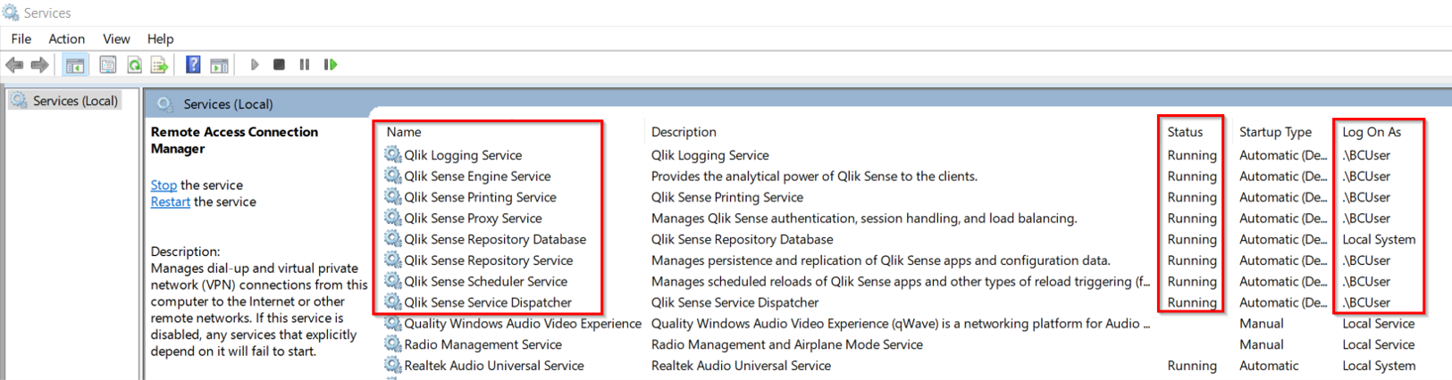

If you suspect that you have encountered an error related to the RESEARCH module, try the following:
  1. BriefCam uses Qlik Sense technology to display dashboards in the RESEARCH solution. Check that the Qlik Services are running.
