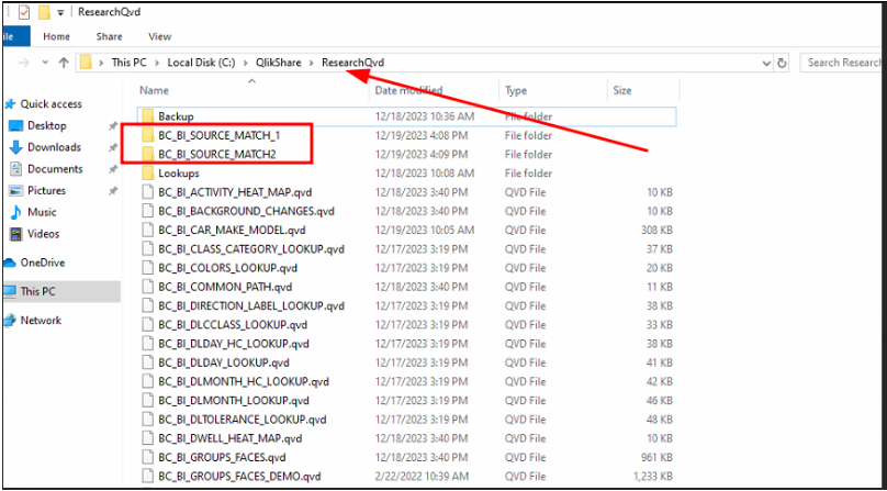

  1. From the ResearchQvd folder (located by default at: C:/QlikShare), delete the following:
    • BC_BI_SOURCE_MATCH_1 folder
    • BC_BI_SOURCE_MATCH2 folder
    • expected_migration.txt file (if it exists)
