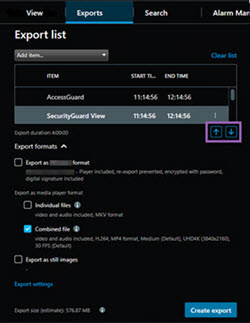

Media player format settings—combined file
Choose the media player format Combined file to export several video or audio sequences from various cameras combined into one file that the recipient can view or listen to on computers with a standard media player installed.
