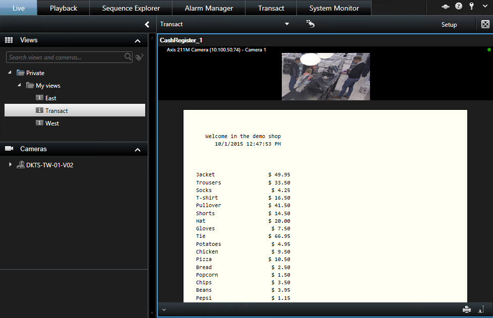

Observe live transactions
You can observe real time transactions in combination with live video surveillance from the cameras recording the transactions. For example, you may want to observe a cash register, the sales clerk, and the ongoing transactions.
 Requirements
Requirements
                                You have set up a view to display transactions. For more information, see Set up views for transactions.
Steps:
- On the Live tab, expand the Views pane.
                                    Select a view set up for transactions. Receipts roll over the screen if there are ongoing transactions, and the live video from the associated cameras are displayed.
If the transaction view item is narrower than the receipt, a horizontal scroll bar allows you to view the part of the receipt that is hidden. If you try to access the scroll bar, the view item toolbar appears covering the scroll bar. To access the scroll bar, press and hold down Ctrl while moving the cursor into the view item area.
Select  to change the font size of receipts.
