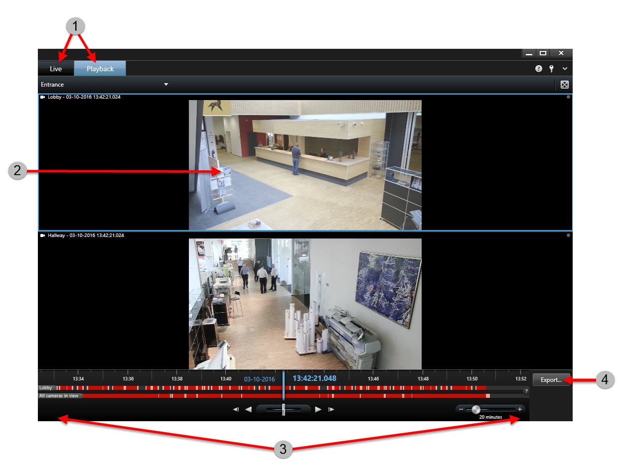

Simplified mode overview
The simplified mode provides only the most basic features. You can toggle between simplified and advanced mode by clicking
Toggle simplified or advanced mode.
View video - view live video, or play back recorded video to investigate an incident. Select a different view to view video from other cameras or other types of content.For more information, see:
Get a closer look - tap or double-click a video to view it in full-screen mode. Tap or double-click again to exit the full-screen mode. Scroll to zoom in and out.
Investigate recordings - Play back video forward or backward in time, adjust the time span, or scroll to quickly browse the recordings. You do this on the Playback tab.For more information, see:
Create documentation - export a video clip or still image
A single static image. that shows what happened. You do this on the Playback tab.For more information, see:

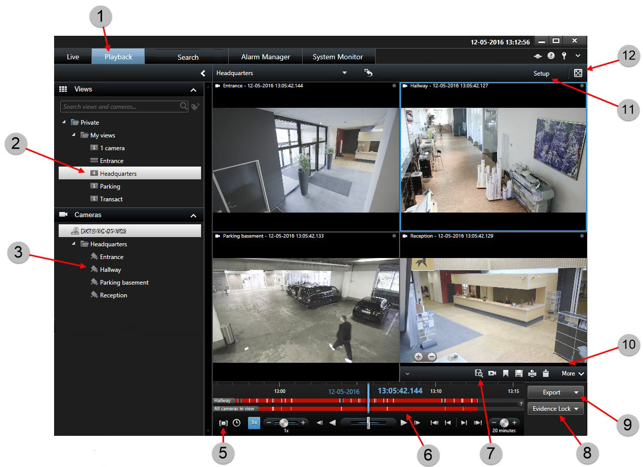

Advanced mode overview (Playback tab)
The picture shows what the Playback tab looks like in advanced mode. To switch to simplified mode, click
View recorded video on the Playback tab. See Viewing recorded video (explained).
Select a view.
Select a time span for exporting video. See Time navigation controls (explained).
Browse using the timeline. See Timeline (explained).
Open a new search window with the camera preselected. See Search for video
Create an evidence lock. See Evidence locks (explained).
Perform various actions on the camera toolbar. See Camera toolbar overview.
Enter setup mode. See Setup mode overview.
View in full screen.

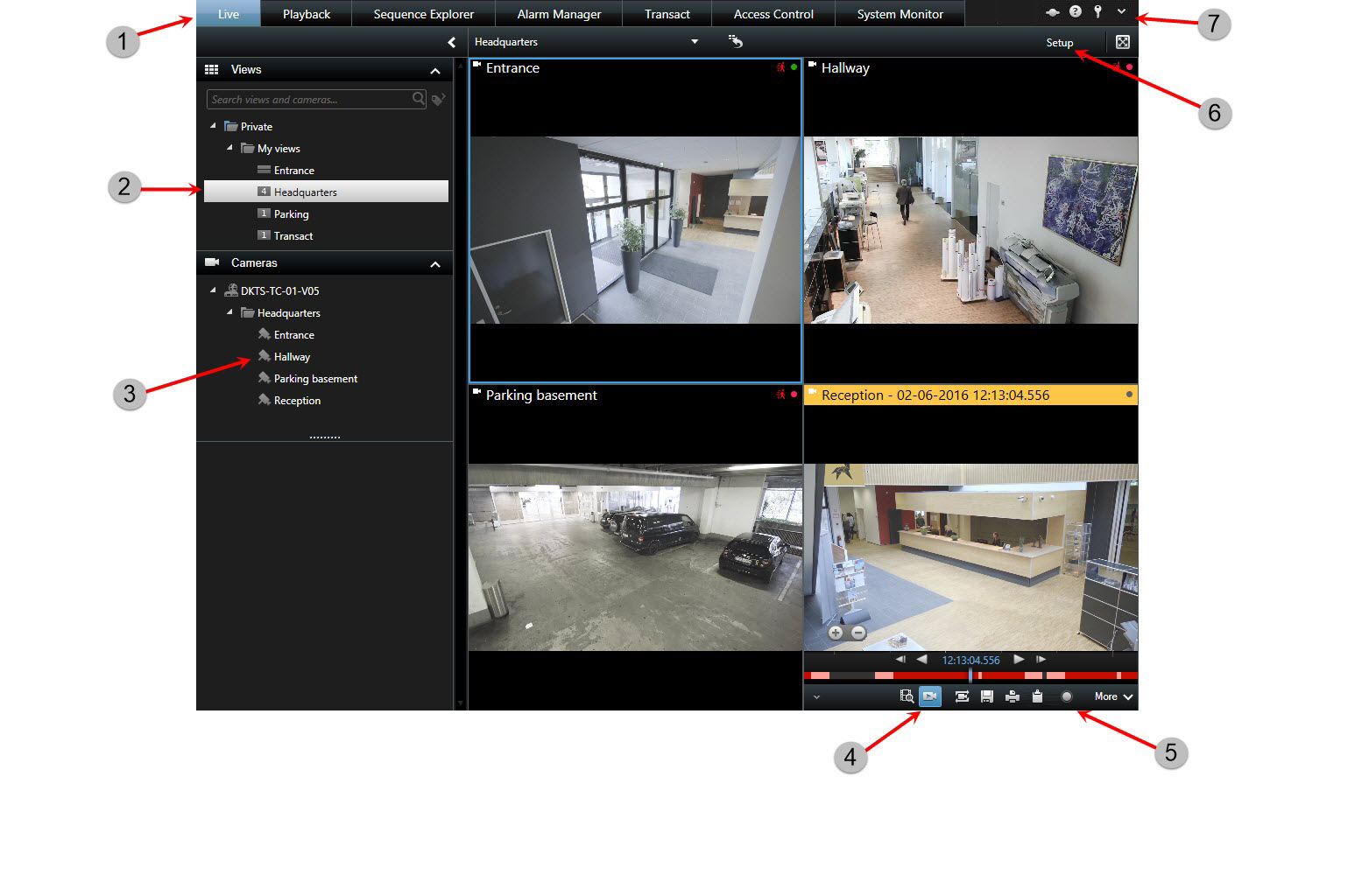

Advanced mode overview (Live tab)
The picture shows what the Live tab looks like in advanced mode. To switch to simplified mode, click
| Button | Function | More information |
1 |
The different work areas. |
For more information, see Tabs in XProtect Smart Client. |
2 |
Select a view. |
For more information, see Views and shortcuts (explained) |
3 |
Change cameras in views. |
For more information, see Change cameras in views |
4 |
View recorded video using independent playback. |
For more information, see View recorded video independently of timeline |
5 |
The camera toolbar. |
For more information, see Camera toolbar overview |
6 |
Enter or exit setup mode to add cameras and other types of content to your views. |
For more information, see Setup mode overview |
7 |
Application buttons. |
For more information, see Application buttons (explained) |

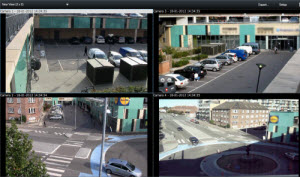

Views (explained)
The way video is displayed in XProtect Smart Client is called a view. A view can contain video from up to 100 cameras, depending on your surveillance system. XProtect Smart Client can handle an unrestricted number of views, allowing you to switch between video from various groups of cameras. The layout of each view can be customized to fit its content. To help you maintain an overview, all views are placed in folders called groups. A group can contain any number of views and, if required, subgroups.
Views can be private or shared with other users.
In addition to video, views can display web pages and still images (for example, mugshots). For some surveillance systems, views can even display data from other applications (such as receipts from a cash register) alongside video. See Content in views (explained).
Your user settings, including information about your views, are stored centrally on the surveillance system server, so you can use your views on any computer that has a XProtect Smart Client installed.

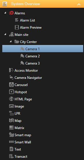

Once you have defined a layout for your view, you can add different types of content to your view items. In setup mode, you can drag and drop these items from the System Overview pane into the view item.
- Alarms - the alarm list and alarm preview you can also find on the Alarm Manager tab
- Cameras - video feed from a live camera or video played back. The cameras appear under the site name, which is defined by your system administrator.
- Access Monitor - with XProtect® Access installed, you can set up access monitors, for example for a specific door
- Camera Navigator - allows you to navigate cameras on a map
- Carousel - shifts between cameras and at a pace that you define
- Hotspot - a hotspot window shows whatever camera is in focus in a high resolution or frame rate
- HTML page - import a webpage into the view, for example the web address of an online news channel
- Image - add images to views, for example to distribute a picture of a suspect.
- LPR - with XProtect® LPR installed, you can add LPR cameras to views
- Image - allows you to share images, for example of suspects
- Map - a floor plan or a geographical area
- Matrix - add a Matrix position to a view. See Matrix (explained)
- Smart Map - a geographical world map based on existing online map services, for example Google Maps and OpenStreetMap.
- Smart Wall - if XProtect Smart Wall has been configured by your system administrator, you can add video walls to your views. See XProtect Smart Wall (explained)
- Text - add text to you views
- Transact - if XProtect Transact has been installed in your system, you can add point-of-sales systems together with cameras.

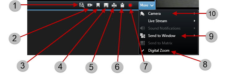

Add a bookmark. See Bookmarks (explained)

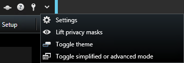

With the application buttons in the toolbar, you can select basic XProtect Smart Client actions:
- Status: Access the Status window. See Status window (explained)
- Help: Access the help system, play online video tutorials or view version number and plug-in information. See View version and plug-in information
- Log out: Log out XProtect Smart Client. See Log in and out
- Settings: Configure XProtect Smart Client settings and behavior, joysticks, keyboard shortcuts, and language. See Settings window )
- Lift privacy masks: Users with sufficient rights can temporary lift privacy masks
A blurred or solid color that covers an area of the video in the camera view. The defined areas are blurred or covered in live, playback, hotspot, carousel, smart map, smart search, and export modes in the clients.. See Privacy masking (explained) - Toggle theme: Switch the XProtect Smart Client theme to dark or light
- Toggle simplified or advanced mode: Switch between simplified mode and advanced mode. See Modes in XProtect Smart Client (explained)
