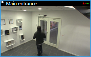

If title bars have been enabled in the Settings window, the title bar above the images indicates if video is being recorded. Sometimes the camera is recording for short periods only. This is because the system server may have been configured to only record when there is motion, when a door is open, or similar.

The camera indicators show you the status of the video that is displayed in the camera view items. The camera indicators are visible only if the camera title bar is enabled.
To enable the camera title bar, on the Live or Playback tab, click Setup and select the Show title bar check box in the Properties pane.
The list describes the different camera indicators that appear when:
motion is detected. Click inside the image to reset the motion indicator -
the server connection to the camera is lost -
video from the camera is being recorded -
a connection to the camera is established. This icon is only relevant for live video -
playing back recorded video -
no new images have been received from the server for more than two seconds
