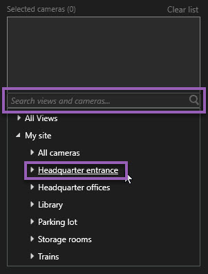

In the Selected cameras list, do one of the following to add cameras to your search:
- Use the search function to find cameras or views
- Manually select the cameras in the tree structure. To add all cameras within a view, select the name of the view
As you add cameras, the search is run immediately.

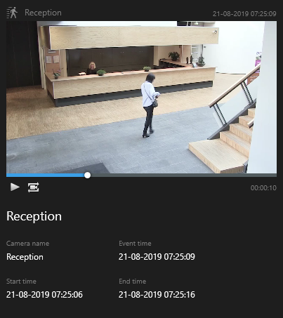

Search for motion
When you search for video recordings with motion, you can apply smart search
A search feature that lets you find video with motion in one or more selected areas of recordings from one or more cameras. filters to show only search results with
motion in areas that you define.
Use smart search to find video footage of a person entering through a doorway that is monitored by multiple cameras.
To use smart search filters, smart search must be enabled on your user profile by your system administrator.
Steps:
- On the Search tab, select a time span.
- Select the cameras that you want to include in your search.
- Click Search for > Motion > New search. If the database has any recordings with motion within the selected time span and cameras, the recordings appear as thumbnail images in the search results pane.

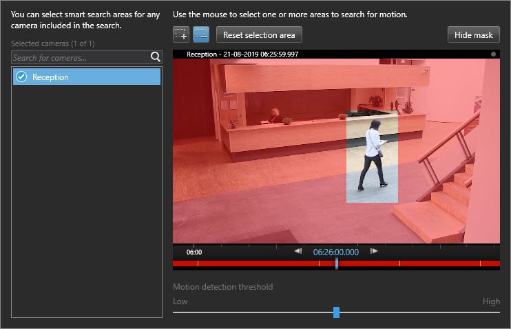

- To find motion in selected areas only:
Below Motion, click 0 cameras selected.
A dialog box appears with a list of the cameras that you selected.
Select one camera at a time and, in the red preview area, click and drag to unmask at least one area. The system will look for motion only in that area. You can unmask multiple areas.
The sensitivity of the motion detection is defined by your system administrator in Management Client on individual cameras. However, you can use the slider to adjust the sensitivity. For more information, see Smart search and motion threshold (explained).
- Automatically, the search is run. Click outside the dialog to return to the search results.
When you search for motion in selected areas of a camera, you can adjust the motion threshold. The motion
threshold determines the smart search
sensitivity:
- The higher the threshold, the more motion is required to activate motion detection. Likely, this will produce fewer search results.
- The lower the threshold, the less motion is required to activate motion detection. Likely, this will produce more search results.

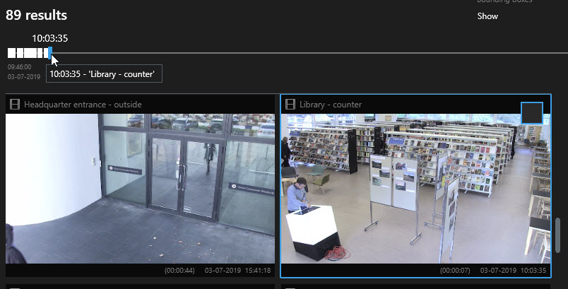

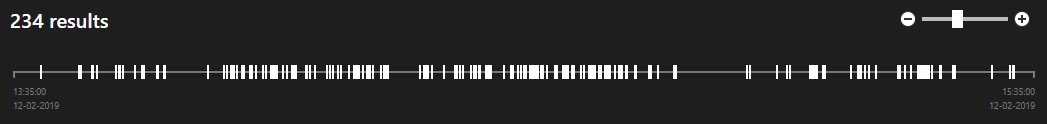

Timeline on Search tab (explained)
The timeline gives you an overview of how the search results are distributed. The timeline also allows you to navigate the search results.
The scope of the timeline changes according to the selected time span, for example Last 6 hours.
The white markers indicate where the search results are.
Individual markers may indicate that there are multiple search results. By hovering over the markers, information is displayed about the time and the cameras that recorded the events or incidents.
To navigate the search results, click a marker. The marker turns blue, and the associated search result is marked with a blue border.
If the marker that you select shows more than one search result, the first search result is marked.
If a marker indicates more than 10 search results, a message will inform you about the number of search results and the number of associated cameras.

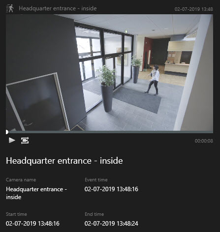

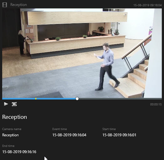

Preview video from search results
To determine whether you have found the video sequence you were looking for, you can do a quick preview.
Steps:
When you have run a search on the Search tab, select a search result. A still image from the associated video sequence appears in the preview area.
- Click
to play back the video. - To preview the video in full-screen mode, double-click the individual search results. Double-click again to return to the search results.
- Scroll with your mouse wheel to zoom in or out. You can even click and drag to zoom in on a specific area.
The yellow marker in the timeline indicates the event time.

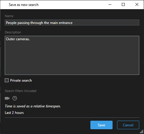

Save searches
You can save your searches, so you can reuse them later or share them with other operators.
To save new searches that will be available to other users of your VMS
Short for "Video Management Software". system, the Create public searches user right must be enabled on your role in
XProtect Management Client.
Steps:
- On the Search tab, configure your search. See Search for video.
Click
to the right of
Search filters. -
In the list that appears, click Save as. A window appears.
- Select a name that will make it easy for you to find the search, and possibly also a description. Later, when you use keywords to find the search, the search includes both the Name and the Description fields.
- To make the search visible only to you, select the Private search check box.
- Click Save. A progress bar informs you when the search is saved.

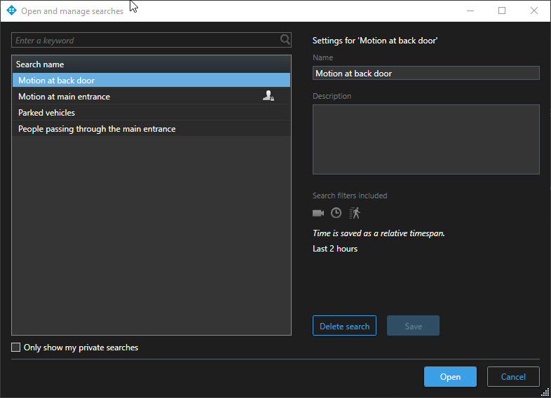

Find and open saved searches
To find and open public searches, the Read public searches user right must be enabled on your role in XProtect Management Client.
Steps:
On the Search tab, click
to the right of Search filters. -
In the list that appears, click Open and manage searches. A window appears.
Find and double-click the search that you want to open, or click Open. Immediately, the search is run.
If many searches are listed, you can use keywords to find the search. The search includes both the Name field and the Description field.
- You can modify the search, for example by adding cameras. Click
> Save to save the changes.

Learn how to:
to the right of
Search filters.
- In the list that appears, click Open and manage searches. A window appears.
- Find and select the search that you want to change.
- Make your changes, for example by entering a name for the search, and click Save.
to the right of
Search filters.
If many searches are listed, use the search function to find the search.
- Modify the search, for example by adding cameras, and click
> Save.
- Open the Open and manage searches window as described above.
- Find and select the search that you want to delete.
- Click Delete search.
