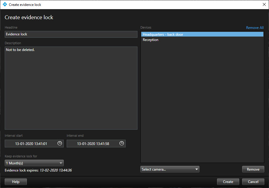

To the right of the timeline, click Evidence Lock > Create. A window appears.
- Give the evidence lock a headline and, optionally, a description.
- For information about the remaining fields, see Evidence lock settings.
- Click Create. If the evidence lock was created successfully, you can click Details to see what went well and what did not. See Evidence lock status messages.
In the list of search results, select the video sequences that you want to protect from being deleted. The action bar appears. Data from related devices will also be protected.
Click
Create evidence lock. In the window that appears, the cameras associated with the selected search results are listed. - Give the evidence lock a headline and, optionally, a description.
- The timespan covers all the selected search results. To change the timespan, use the Interval start and Interval end fields.
- Click Create. A window appears informing you about the progress of the evidence lock. Click Details to see what went well and what did not. See Evidence lock status messages.
Name |
Description |
| Headline |
The headline of the evidence lock. |
| Description |
A description of the evidence lock. |
| Interval start |
Adjust the start date and time for the video sequences you want to protect. |
| Interval end |
Adjust the end date and time for the video sequences you want to protect. |
| Keep evidence lock for |
Specify for how long you want to keep the evidence protected. Depending on you user rights, you can have the following options: hour(s), day(s), week(s), month(s), year(s), indefinite or user-defined. If you select User-defined, click the calendar button to select a date and then adjust the time manually. When done, the date and time for when the evidence lock expires is shown. |
| Select camera |
Click to select more cameras to include in the evidence lock. |
| Remove/Remove All |
Click to remove one selected camera or all cameras from the evidence lock. |
