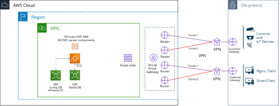

Figure 6. Principal design of a redundant Site-to-Site VPN topology for a single site deployment
Designing the network topology connecting the customer site(s), one should consider required bandwidth for video streams and client access, and factor in peak situations and the need for redundancy. Figure 6 presents a principal redundant VPN design for a single site deployment. It should be noted that each VPN connection is made up by two separate IPsec tunnels, which represent the first level of redundancy in the event of a device failure within AWS. Second level redundancy is achieved by the two separate VPN connections, each handled by its dedicated customer gateway device. It is further recommended that these two VPN connections are routed via two different Internet Service Providers to ensure maximal redundancy. The VPN gateway that facilitates the Site-to-Site connectivity is attached to the XProtect VPC via the routing table.

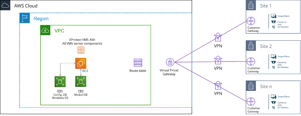

Enterprises and organizations often have geographically dispersed facilities and offices, where the security operation is to be coordinated in one centrally managed video management system. To support this, the individual sites can be connected to the XProtect VPC using the AWS Site-to-Site VPN service, as illustrated in Figure 7. Please note that the figure does not consider redundancy in the VPN topology.
In larger deployments it is important to consider that the maximum throughput of an individual VPN tunnel is 1,25 Gbps, and that the Virtual Private Gateway are bound by an aggregate throughput limit from AWS to on-premises of up to 1,25 Gbps. For AWS Direct Connect connection on a Virtual Private Gateway, the throughput is bound by the Direct Connect physical port itself. To connect to multiple VPCs and achieve higher throughput limits, use AWS Transit Gateway.

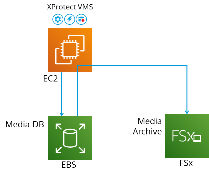

Figure 8. XProtect media storage utilizes a combination of EBS and FSx storage for optimal combination of storage performance and cost
Figure 8 depicts the recommended storage infrastructure when running XProtect on AWS without any third party plugin or add-on that facilitates archiving, where the recording server’s media database is hosted in an EBS general purpose SSD (gp2) storage volume and the media archives are stored in one of more Amazon FSx for Windows File Server storage volumes, dependent on the amount of video and other media data that is to be stored. In this setup the native XProtect video archiving function is used to move, and life cycle manage the video across the EBS and the FSx storage arrays.
The default deployment of XProtect BYOL CloudFormation configures the Elastic Block Store (EBS) for the media database only. This means that the FSx storage shall be added to the installation when and as needed. The FSx storage is available in single-AZ and multi-AZ deployment options, which offers an additional level of redundancy for end-customers with high demands on data resilience. Also, another option for storage is S3 as now the option is provided in the CloudFormation Template.
