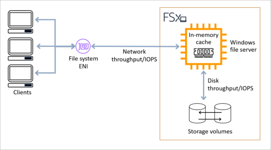

The FSx file system is defined with a storage size and throughput capacity. As these definitions cannot be changed at a later stage it is important to dimension the FSx correctly. The effective throughput and IOPS of FSx files storage is dependent on both the network throughput and IOPS towards FSx, and the internal disc throughput and IOPS performance, as depicted in Figure 18.

Figure 18. Detailed FSx file storage architecture illustrating the difference between network throughput/IOPS and disk throughput/IOPS
The type and amount of storage capacity impacts the performance of the FSx file system. The FSx storage is defined in steps of 1 GiB with a minimum size of 2 TiB and a maximum size of 64 TiB, where the disk performance for HDD based storage is proportional to the volume size.

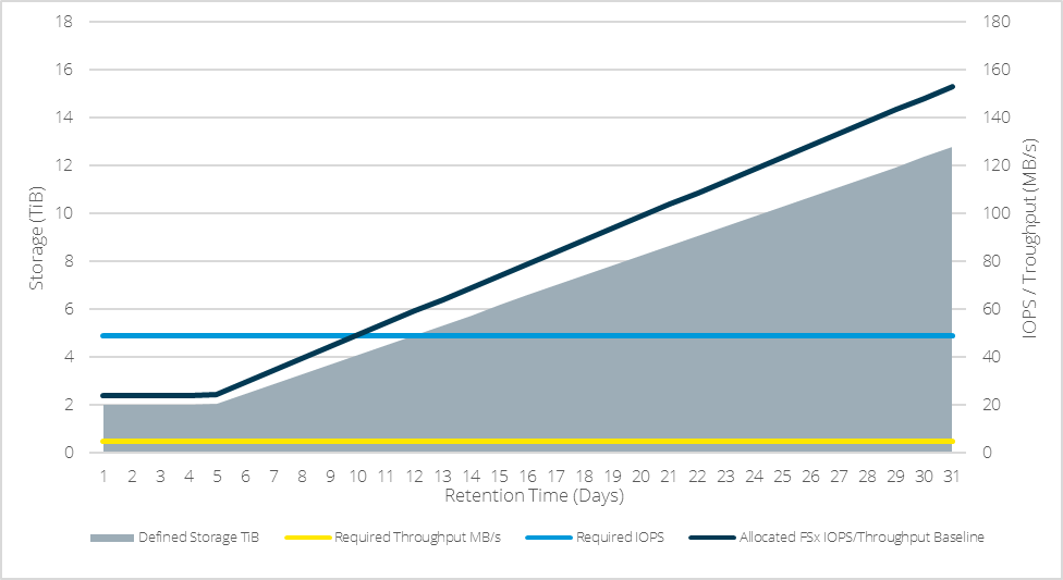

The graph in Figure 19 illustrates the dependencies between the required FSx storage volume for different retention times (calculated based on the video data volume to be archived), required throughput (yellow line) and required number of IOPS (light blue line), and the allocated disc throughput and IOPS baseline (dark blue line). More specifically this graph represents a deployment with 100 cameras, each generating 4 Mbit/s. The assumption is that the VMS system on average records 10% during a day. This means that the required throughput is 5 MB/s and the required IOPS to write the video data to the FSx disk system is 49 operations per second line.
Given the volume of video data to be archived (5 MB/s) the required storage per retention day is 0,37 TiB (gray area). In this example we assume that the FSx storage definition is fully optimized to match the required storage exactly. Based on the FSx storage definition a disc throughput and IOPS baseline allocation is given, as discussed in Table 5.
Figure 19. FSx performance at different size definitions, compared with required performance for archiving in a system with 100 cameras generating 4 Mbit/s, with 10% recording
From Figure 19 it can be derived that special care needs to be taken when dimensioning an HDD based FSx file system with short retention times. We can see that the allocated disk IOPS is lower that the required number of disk operations, for FSx storage volumes smaller than 4,12 TiB. This will result in a situation where the media storage on the EBS disc cannot be archived fast enough, which will eventually cause the storage system to overflow where video data will be lost.
To secure a sustained operation in this specific case the FSx storage should in this particular case not be smaller than 4,12 TiB, even for the shorter retention times, to obtain a sufficient IOPS baseline. In a real-life deployment, Milestone of course recommends a reasonable margin on the storage definitions, to not end up with system bottlenecks.
