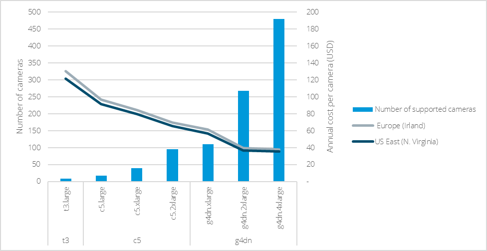

To help system integrators and end-customers select the most optimal compute-infrastructure for their XProtect deployment. Figure 17 presents the price performance ratio for the recommended EC2 instance types listed in Table 4. The dark blue line and the gray line lists the annual cost per camera for US East (N. Virginia) and Europe (Ireland), respectively at maximum recommended utilization, at 25% recording, and archiving to AWS FSx storage.
Figure 17. Price-performance ration of recommended EC2 instances for deployments with H.264 video streams with 1080p resolution and 30 FPS, with a constant throughput of 4,0 Mbps per camera. Server-side VMD is applied on all streams, with 25% recording, and archiving to AWS FSx storage.
