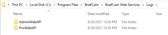

Log Files for BriefCam’s Web Services
The following are log files related to BriefCam's Web services:
The last 250 MB of each day’s log files will be saved for up to 14 days. These default values can be changed using the environment settings as described in the Server-related Log Files section above.

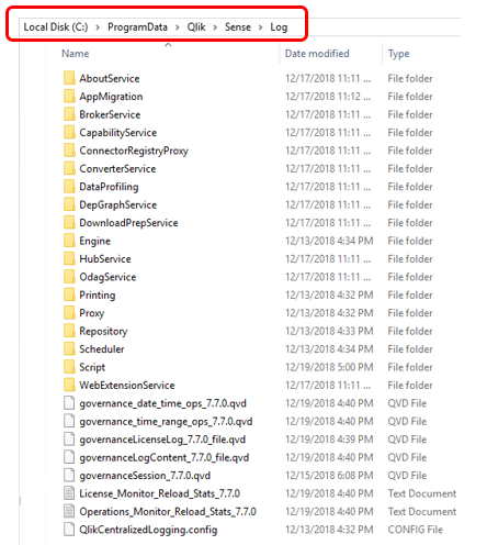

Qlik Log Files
This log file is located at: C:\ProgramData\Qlik\Sense\Log.
Note
ProgramData is a hidden folder.
To minimize the growth of the Qlik trace log folder, continuously back up and remove files that have not been modified for a period of time.
Each element has separate log files, such as Engine and App Migration.
