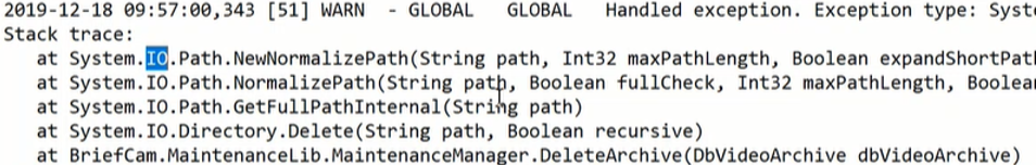

Why am I seeing a System.IO error in the log?
Version2024r2
LanguageEnglish
If you see IO in the log, you know it’s a file system issue. The IO errors are almost always related to permissions or changes in the folder structure.
