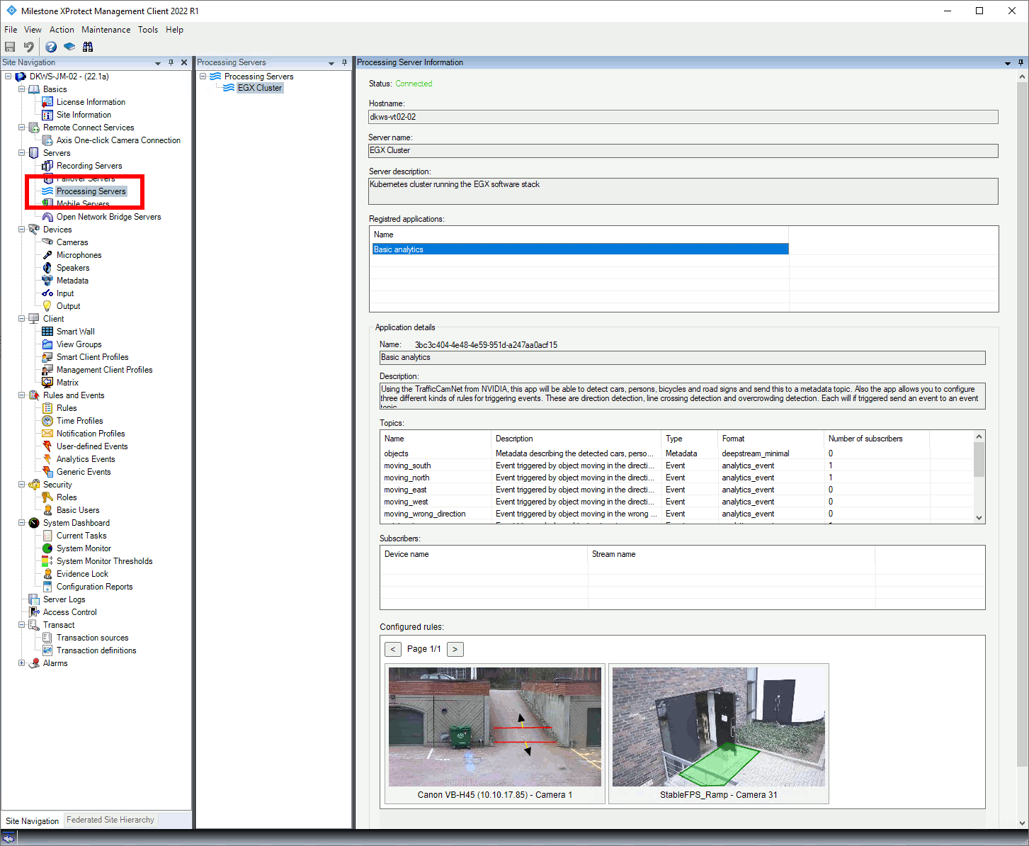

  3. Start or restart the XProtect Management Client to finalize the installation. In Management Client > Site Navigation pane > Servers, a new Processing Servers node will be displayed.
Example of the Processing Servers node
In this example, there is one registered Milestone AI Bridge processing server called EGX Cluster, with one registered IVA application.
Example of Processing Server node with IVA application setup.
The EGX Cluster processing server is running the Basic analytics IVA application and the Basic analytics application has registered a number of analytics topics. An analytics topic is a named feed that the analytics application can send data to:
  • objects
  • moving_south
  • moving_north
  • moving_east
  • moving_west
  • moving_wrong_direction
  • etc
The moving_ topics are event topics which can receive event data from the Basic analytics application if an object is detected to be moving in a certain direction (South, North, East, West or in the wrong direction).
The objects topic is a metadata topic.
The rules for triggering events are visually displayed in the Configured rules group at the bottom of the page. Here two rules for triggering are displayed:
  • Camera 1: arriving_to_area or leaving_from_area
  • Camera 31: zone_has_unexpected_activity

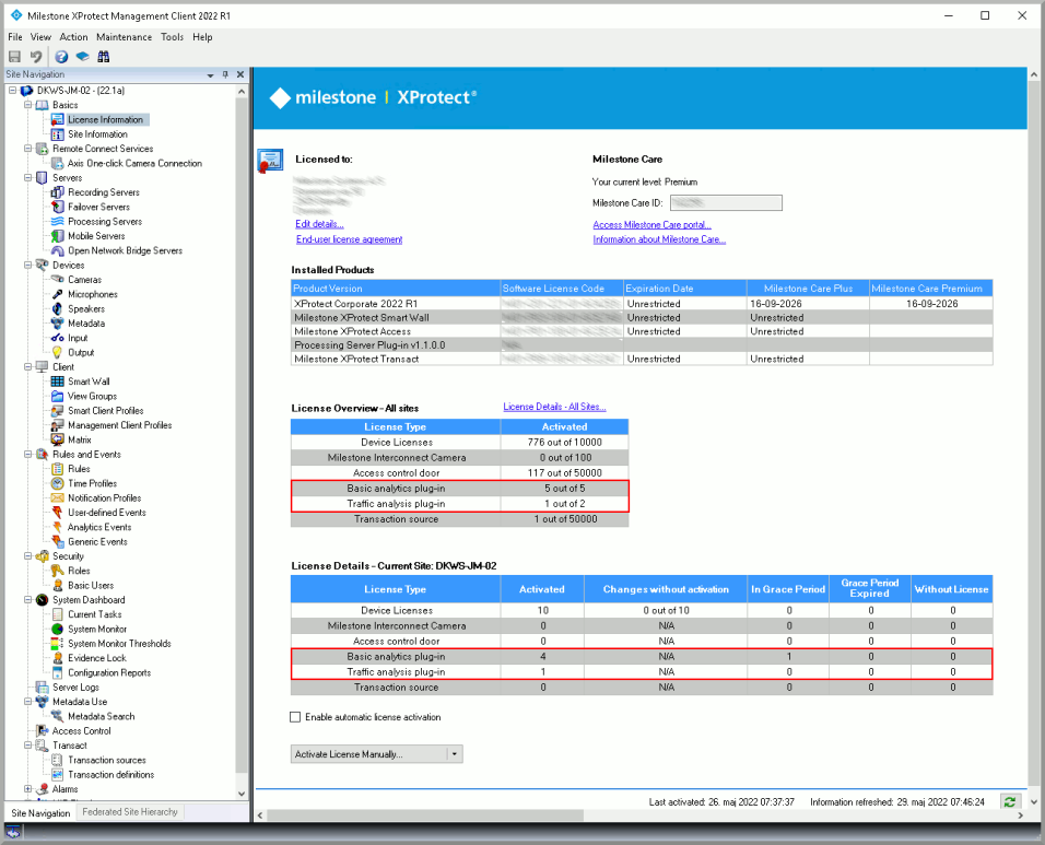

IVA license activation
The Milestone AI Bridge enables you to license your own IVA integration through the Milestone License Server.
This allows you to issue and manage licenses to customers through MyMilestone and the MIP License Management Tool. However, for the license activation to work, you must first apply the Milestone AI Bridge patch to all XProtect versions older than XProtect 2022 R2
For XProtect 2022R3 and later, the updates contained in the patch are part of the product by default.
When the patch is successfully applied, your own Video Analytics Apps will be displayed on the License page in the XProtect Management Client.
If you don't use the XProtect Management Client License Activation feature, you will not need to apply the Milestone AI Bridge patch.
