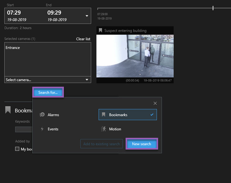

  3. On the Selected cameras list filter selector, use the Select camera search field to find cameras or views and then select the cameras which video sequences you want to search in.
  4. Select Search for to select one or more search categories.
    Specify what to search for in XProtect Smart Client.

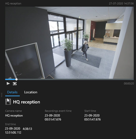

  6. To preview the video of a search result, select the search result and, in the preview pane, select Play forward.
    Preview search results in XProtect Smart Client.
    To play back the video sequence in full-screen mode, double-click the search result.
