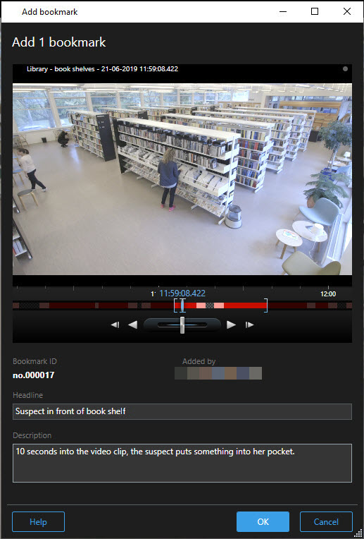

Add or edit bookmarks
You can add bookmarks to live and recorded video. If you have enabled detailed bookmarks, you can give the bookmark a name and a description. You can even adjust the time span. Later, you can find and edit the bookmark details.
 Requirements:
Requirements:
                                Detailed bookmarks must be enabled. For more information, see Enable detailed bookmarks.
Steps:
- Select the required camera in the view.
- Click the bookmark icon  . With details enabled, the Bookmark window appears where you can add a detailed description of the incident. . With details enabled, the Bookmark window appears where you can add a detailed description of the incident.
- Enter a name for the bookmark.
- The length of a bookmark clip is determined on the surveillance system server, but you can change this by dragging the timeline indicators.
- (optional) Describe the incident.
- Click OK.
To find and edit the bookmark later, go to the Search tab and search for bookmarks. See Search for bookmarks.

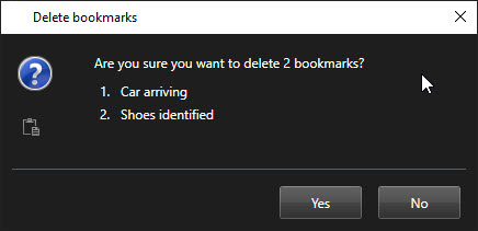

- On the Search tab, find the bookmarks that you want to delete.
- In the search results, hover over each of these bookmarks and select the blue check box  . .
                                    In the blue action bar, click  and select Delete bookmark. A window appears. and select Delete bookmark. A window appears.
                                    Click Yes to delete the bookmarks. There may be restrictions in your system preventing you from deleting certain bookmarks. In that case, you will be notified.
