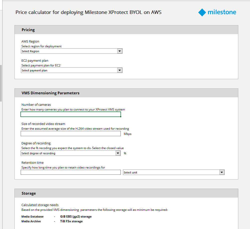

Price calculator
To simplify the price calculation of running XProtect on AWS, Milestone provides a price calculator. Click here to download the XProtect on AWS calculator. Please note that this calculator is intended to provide an indicative price only. As it is based on a set of service execution assumptions, the final cost can only be determined by the final deployment and the contractual agreements with AWS.
Figure 12. The XProtect BYOL price calculator makes it easy to calculate the AWS service costs for running XProtect on AWS

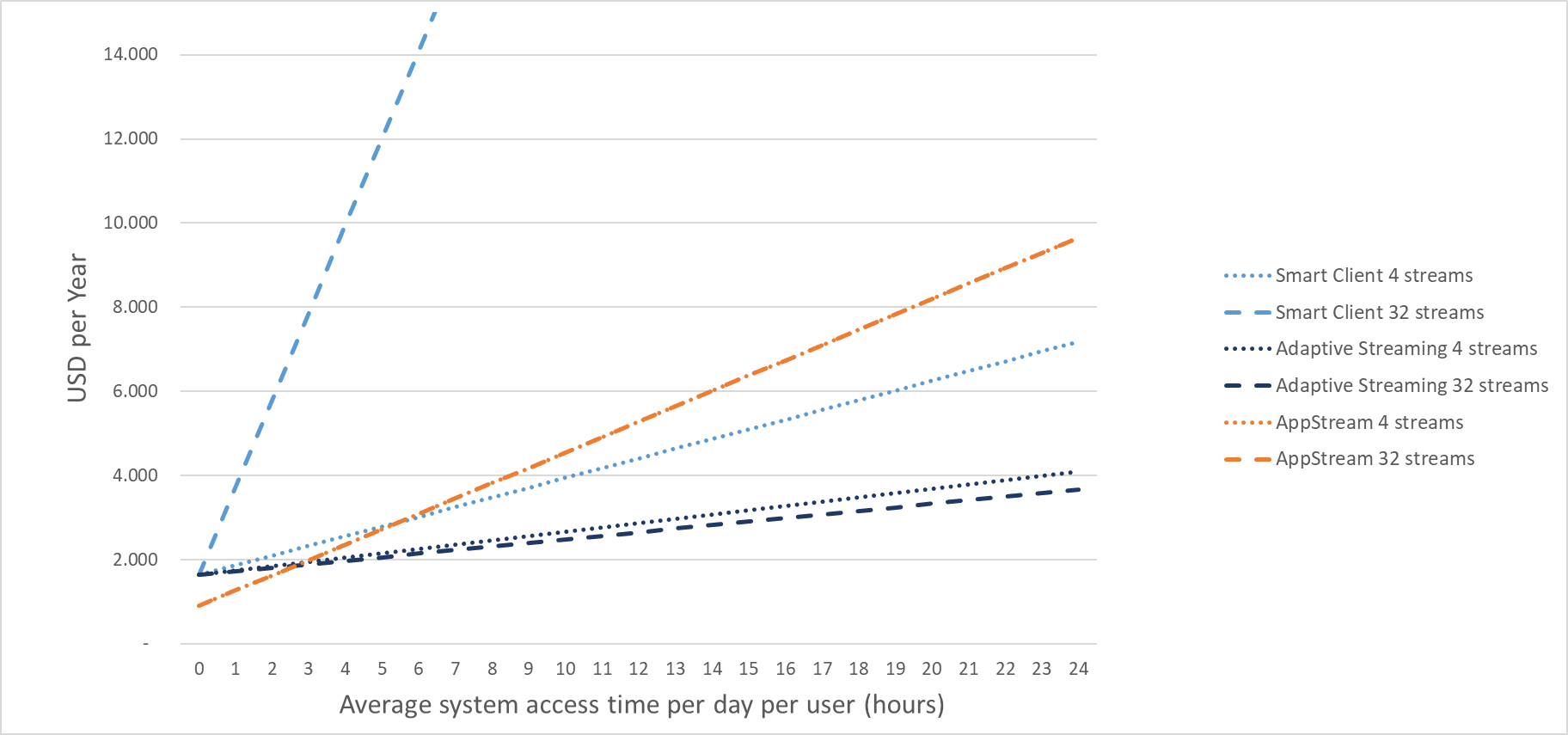

Figure 13 illustrates the complexity in estimating the data egress costs, and the importance of optimizing these costs. The graph presents the yearly cost for one user accessing the XProtect VMS system through different methods at different usage patterns both in terms of average usage time per day (the x-axis) and how many camera streams that are viewed (4 and 36 cameras respectively). The three user access methods illustrated in the graph are:
  • XProtect Smart Client with Full HD (H.264 at 1080p) streams at 30 frames per second, corresponding to 4 Mbit/s per viewed stream.
  • XProtect Smart Client with adaptive Streaming, where alternative streams with lower resolution have been selected. When viewing 4 streams, 720p streams have been selected, and when viewing 36 cameras, 240p streams have been selected.
  • AppStream 2.0 with XProtect Smart Client hosted on a g4dn.xlarge EC2 instance type.
Figure 13. Accumulated yearly user access cost for different user access methods at different levels of average daily usage. The cost includes VPC data egress costs US East (N. Virginia) and workstation hardware costs, and presented for 4 and 32 H.264 streams at original stream size of 4 Mbit/s
The hardware cost is based on a 3-year depreciation period.
The graph shows that the yearly cost is a linear function of how many hours a user accesses the system. While the cost grows dramatically when using non adaptive stream access, the adaptive streaming feature keeps the data egress cost at a reasonable level, even when the usage is extensive measured both in number of access hours a day, and number of viewed cameras. Amazon AppStream 2.0 is a viable alternative.
