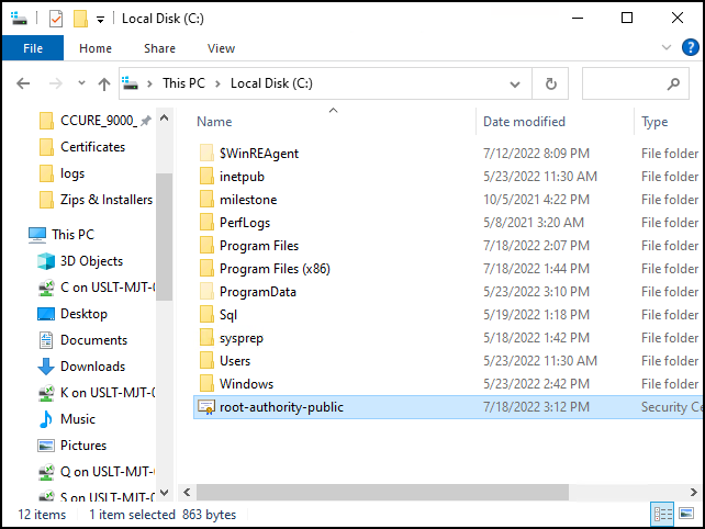

  2. By default the script places the new root certificate in the C:\ file location. Move the certificate to the XProtect server.
  3. On the XProtect server right-click the certificate and select Install Certificate to begin the certificate installation wizard.

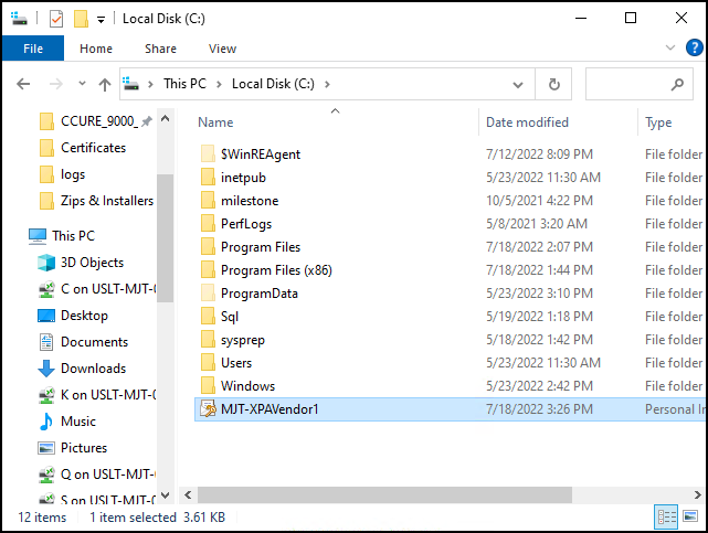

  9. By default the script generates the certificate at the C:\ file location. Copy the file and move it to the server hosting the XProtect OnGuard Integration Service.

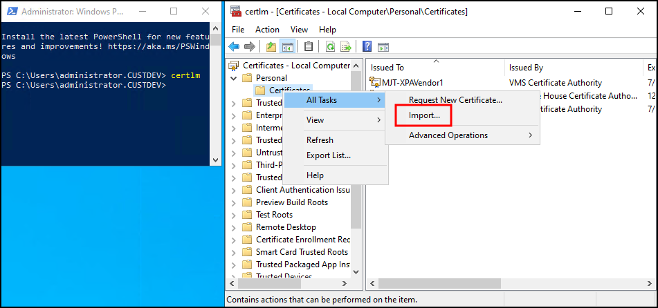

  10. Go to the server hosting the XProtect OnGuard Integration Service and run the certificates snap-in for the local machine. Right-click the Certificate store within the Personal folder and choose to Import a new certificate.
  11. Import the certificate into the store of the local machine. Choose the certificate file that you copied to the local server. Enter the password chosen during the script. Browse to the personal folder of the certificate store to choose that as the location for the certificate. Complete the import wizard
