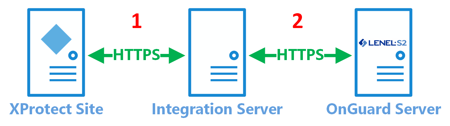

The process of securing communications between OnGuard and XProtect should start after the integration has been installed and configured. There are two different processes required.
  1. Certificate generation, distribution, and configuration supporting secure communications between XProtect and the XProtect OnGuard Integration Service.
  2. Certificate extraction, distribution, and configuration supporting secure communications between OpenAccess and the XProtect OnGuard Integration Service. This process (#2) is required when the XProtect OnGuard Integration Service isn't installed on the OpenAccess host machine.
