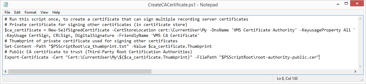

In Appendix A, in the back of this guide, you find a script for creating the CA certificate. Copy the content.
Open Notepad and paste the content.
Important
It is very important that the lines break in the same places as in Appendix A. You can add the line breaks in Notepad or alternatively, reopen this PDF with Google Chrome, copy the content again and paste it into Notepad.
In Notepad, click File -> Save as, name the file
CreateCACertificate.ps1and save it locally, like this:C:\Certificates\CreateCACertificate.ps1.In File Explorer, go to

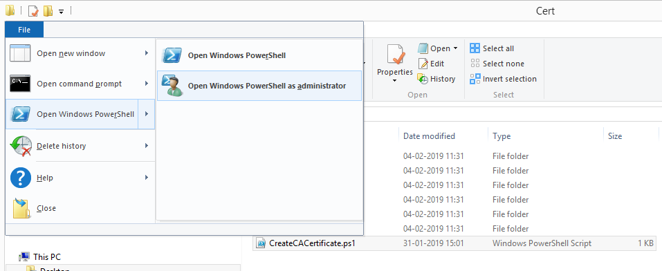

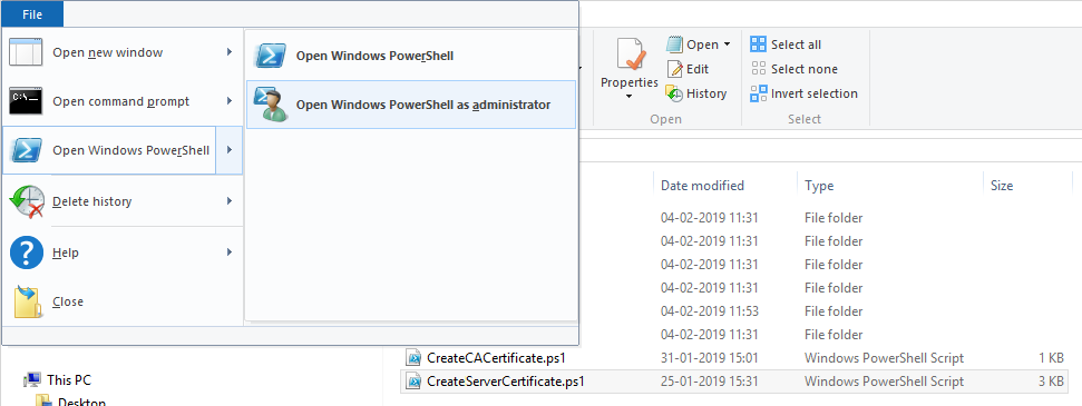

C:\Certificatesand select the CreateCACertificate.ps1 file.In the File menu, select Open Windows PowerShell and then Open Windows PowerShell as administrator.

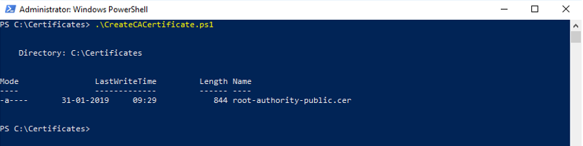

In PowerShell at the prompt, enter
.\CreateCACertificate.ps1and press Enter.
Check that the root-authority-public.cer file appears in the folder where you ran the script.

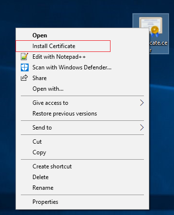

Right-click on the certificate and select Install Certificate.

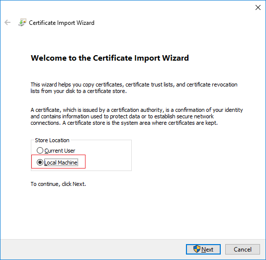

In the Certificate Import Wizard, select to install the certificate in the store of the Local Machine and click Next.

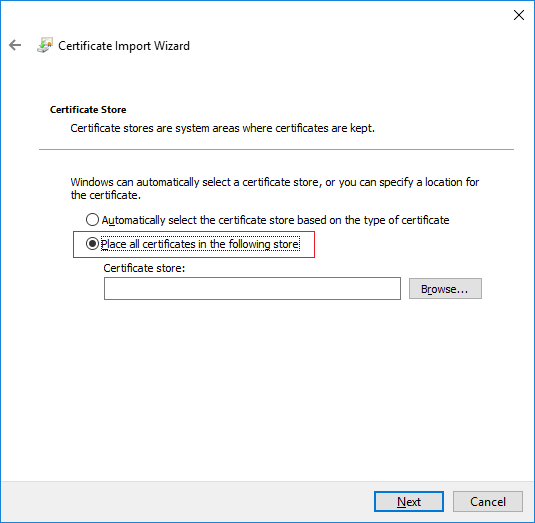

Select to manually locate the store in which the certificate will be installed.

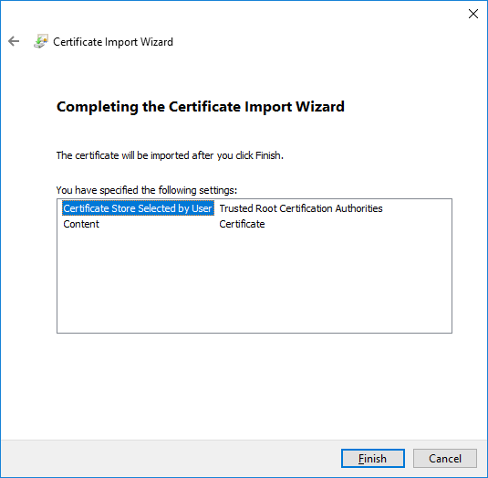

Click Browse, select Trusted Root Certification Authorities and click OK. Then click Next.
On the Completing the Certificate Import Wizard dialog, click Finish.

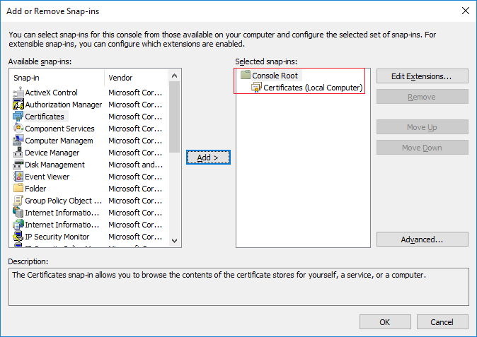

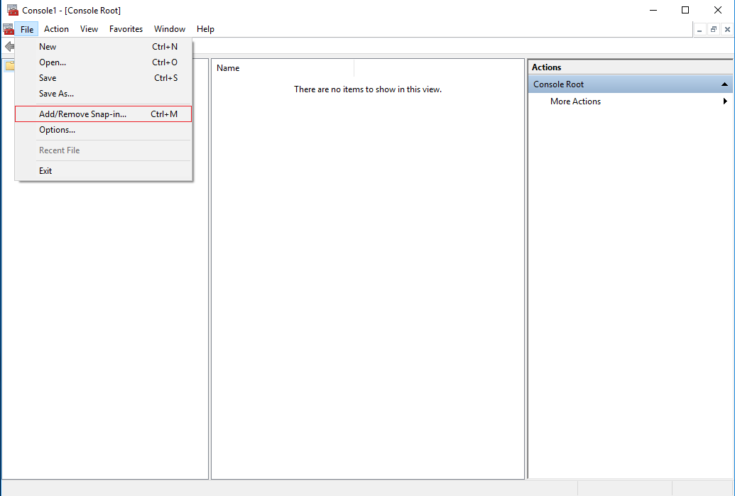

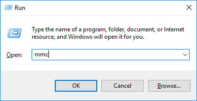

To verify that the certificate is imported, start the Microsoft Management Console.

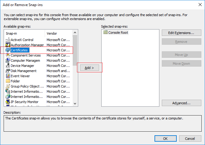

In the Microsoft Management Console, from the File menu select Add/Remove Snap-in….
Select the Certificates snap-in and click Add.

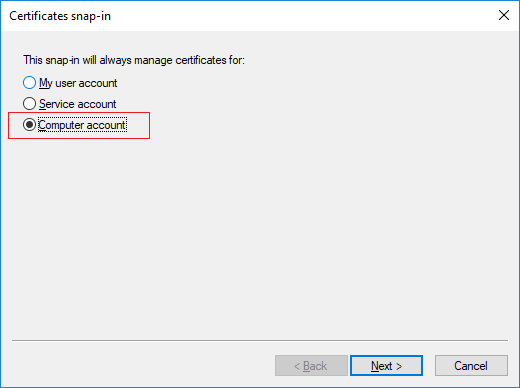

Select that the snap-in must manage certificates for the Computer account.

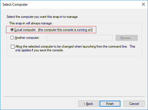

Select Local computer as the computer that you want the snap-in to manage and click Finish.
Click OK after the snap-in has been added.

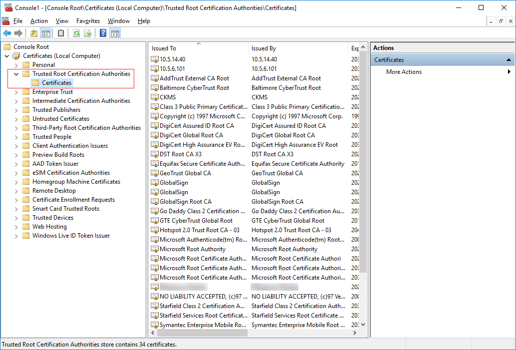

Verify that the certificate is listed in the center view of the Trusted Root Certification Authorities subtree.

C:\Certificatesand select the CreateServerCertificate.ps1 file.In the File menu, select Open Windows PowerShell and then Open Windows PowerShell as administrator.

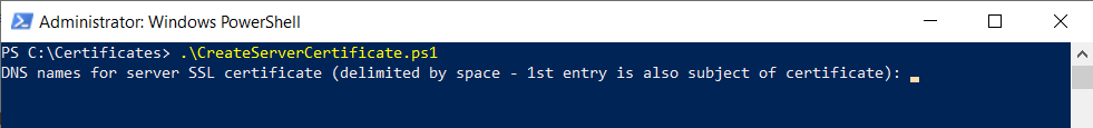

.\CreateServerCertificate.ps1and press Enter.Enter the DNS name for the server. If the server has multiple names, for example for internal and external use, add them here, separated by a space. Press Enter.

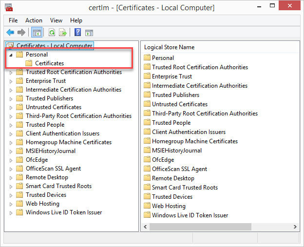

On the server service computer, start Manage computer certificates.
Click on Personal, right-click Certificates and select All Tasks > Import.
Select to import the certificate in the store of the Local Machine and click Next.

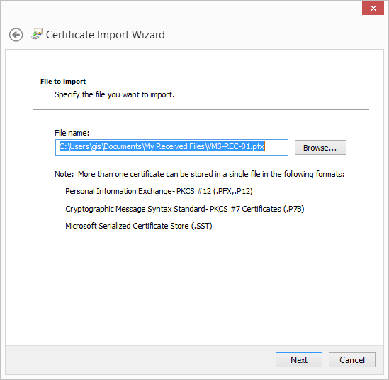

Browse to the certificate file and click Next.

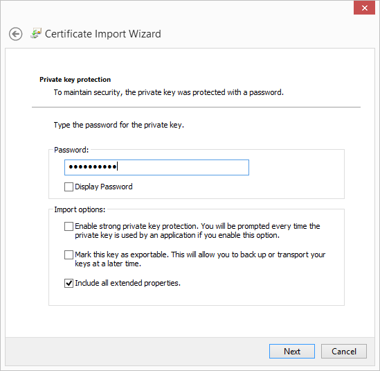

Enter the password for the private key that you specified when you created the server certificate, and click Next.

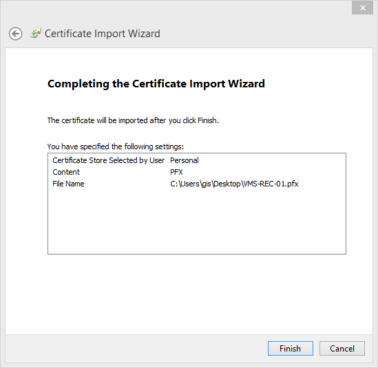

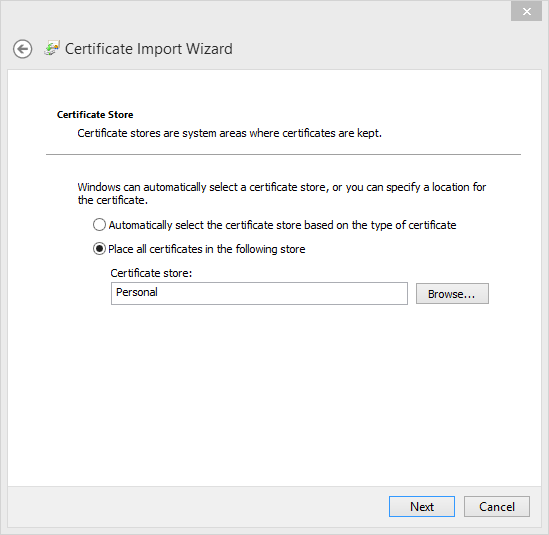

Place the file in the Certificate Store: Personal and click Next.
Verify the information and click Finish to import the certificate.

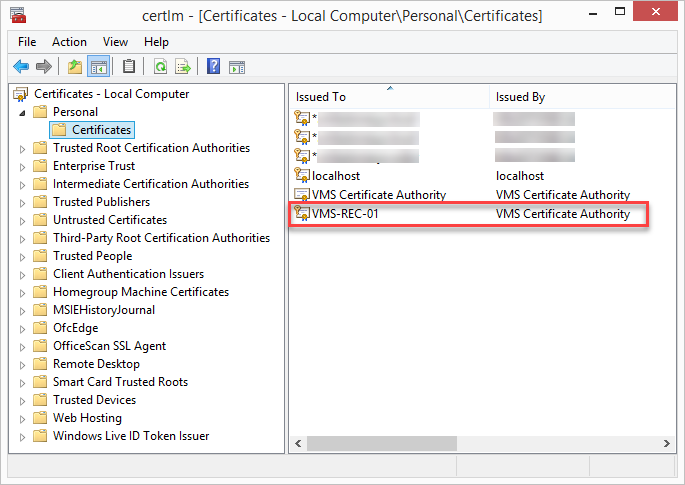

The imported certificate appears in the list.

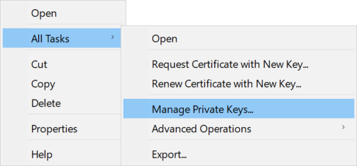

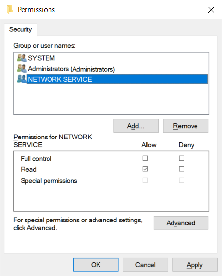

To allow a service to use the private key of the certificate, right click the certificate and select All Tasks > Manage Private Keys.
Add read permission for the user running the XProtect VMS services that need to use the server certificate.
