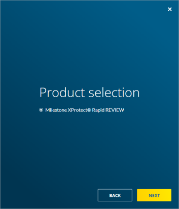

STEP 1 - Run the Installer
XProtect Rapid REVIEW will not work if the minimum requirements are not met. For additional information, see the APPENDIX: XProtect Rapid REVIEW 2024 M1 SP1 hardware recommendations.

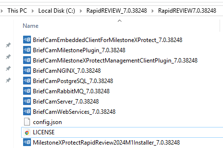

  1. Extract the XProtect Rapid REVIEW package (RapidREVIEW <version>.zip).
  2. The extracted folder includes the XProtect Rapid REVIEW installer, multiple BriefCam installer files and an installation and configuration guide. You do not need to run any of the BriefCam installers (except for the NGINX, embedded client, and management client installers at a later stage).
    BriefCam uses port 80 for its application. If you want to use a different port, change it in the config.json file before running the installer. The config.json file is one of the files in the installation package.

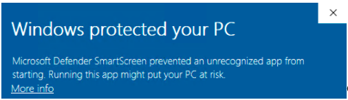

  3. Right-click the MilestoneXProtectRapidReview2024R2M1Installer_7.0.38248.exe file and select Run as administrator.
  4. Read and accept the License Agreement terms and click NEXT.
    When running on a laptop, you may also see a duplicated smaller screen on top of the regular installation screen. To continue, check the check box on the smaller screen and the NEXT button on the larger screen. This is a known issue
  5. The installer will check to see if your computer meets the minimum prerequisites.
    • If all the prerequisites are met, you’ll see a “Your system is fine” message.
    • If any of the prerequisites are not met, you will see a screen describing the warnings. Try resolving the warnings (for more information see the Prerequisites section) and then click RETRY or run the installer again. To resolve the warnings, you can also see the logs and run the standalone Check Prerequisites tool.
      If there are still errors and you click NEXT, the installation will continue. However, may not run properly on your computer since it does not meet the minimum requirements.

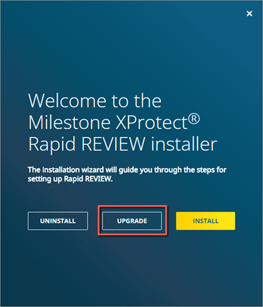

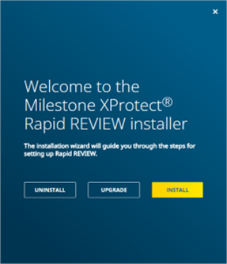

  6. Select whether you want to install, upgrade, or uninstall XProtect Rapid REVIEW.
  7. If you select INSTALL or UPGRADE, the following screen appears.
  8. Click NEXT.

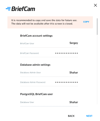

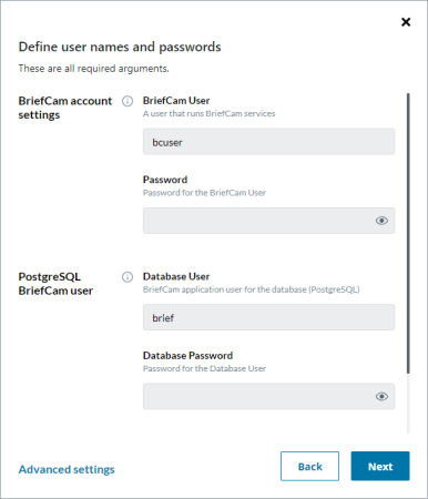

  9. The following screen opens where you’ll enter the necessary credentials and settings.
  10. Fill in the following fields. (You can click the Simple mode option if you only want to show required fields.)
  11. Field Description
    BriefCam account settings (required)
    BriefCam User
    The Windows user that runs the services. If this user does not yet exist, the installer will create it for you.
    Password
    The password of the user above (BriefCam User). Note that apostrophes and double quotes are not supported in the Password field.
    Use a password that is compliant with your organization’s password policy.
    A password may fail for a variety of reasons:
    • The password does not meet the password policy of the operating system and/or organization.
    • Domain accounts cannot be created using this dialog. Contact the relevant IT person if a new domain account is required.
    • If the user is disabled, locked, or otherwise limited.

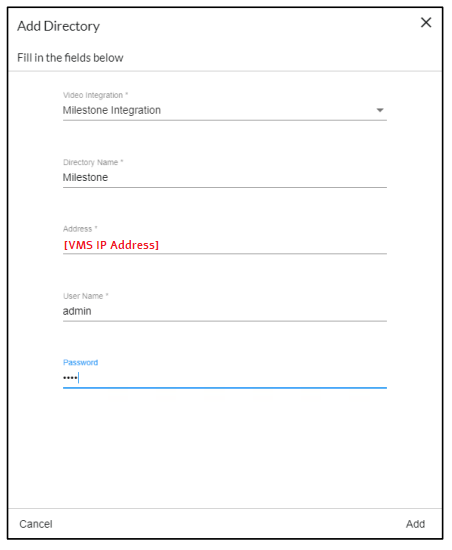

    MilestoneSSO Provider Leave as-is. The endpoint of the Rapid REVIEW-Milestone integration service.
    Milestone VMS Address If you already want to configure the connection to the MilestoneVMS, enter the host or IP address of the Milestone VMS in this field. It is recommended to fill it in.
  12. Click NEXT and a summary screen will appear.
  13. Review the settings and save the settings for future use by clicking the COPY button.

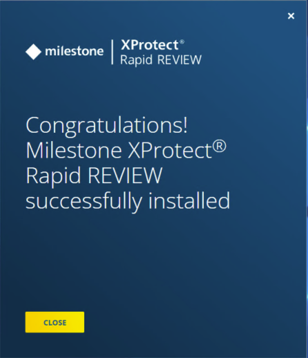

  14. Click NEXT to complete the installation.
  15. The installation may take 10-25 minutes. Note that after the installation is complete, the services will be automatically restarted.

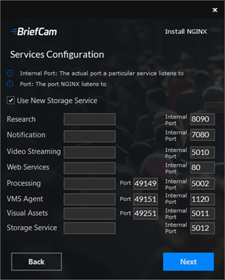

Firewall Consideration and Ports Availability
Internal (Local) Ports
On each server, the following ports should be opened for internal communication:
  • On each server, all outbound ports should be opened, to allow communicating with other servers as needed.
  • On each server, the following inbound ports should be opened according to the installed services. The BriefCam application listens for incoming traffic from these ports. The installer will create the relevant Windows firewall rules for these ports.
Component Port #
BI Face Recognition Service TCP 13004
Face Recognition Matching Service TCP 13002
Filtering Service TCP 13001
License Service TCP 1947
Lighthouse Service TCP 2553, TCP 2554, TCP 2555, TCP 2556, TCP 2557
LPR Matching Service TCP 13003
Milestone TCP 554, TCP 8080
MilestoneSSOProvider TCP 8030
Notification Service TCP 7080
PostgreSQL Redis TCP 5432
Redis TCP 6379
Storage TCP 139, TCP 445
Video Streaming Gateway Service TCP 5010
VSServer Service TCP 1112, TCP 1113
Web Services (BOA, ProWebApi, AdminWebApi) HTTP (80)
External Ports
The following ports should be opened to traffic coming from the end users’ browsers.
Component Port # Comment
Web Services HTTP (80)
Video Streaming Gateway Service TCP 5010 Not needed when using a load balancer

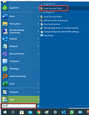

Many of the installers use PowerShell. To enable PowerShell to run, the local computer’s Turn on script execution policy must be enabled or not configured (and not disabled). In addition, the maximum restriction of the policy that can be used is RemoteSigned.
To turn on script execution follow these steps:
  1. From the Windows Start menu, type policy and select Edit group policy to open the local group policy editor.
  2. Navigate to Computer Configuration -> Administrative Templates -> All Settings.
  3. Check that the Turn on Script Execution policy is set to Not configured or Enabled.

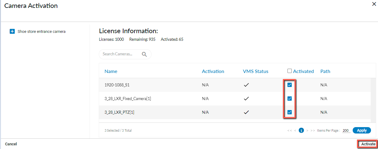

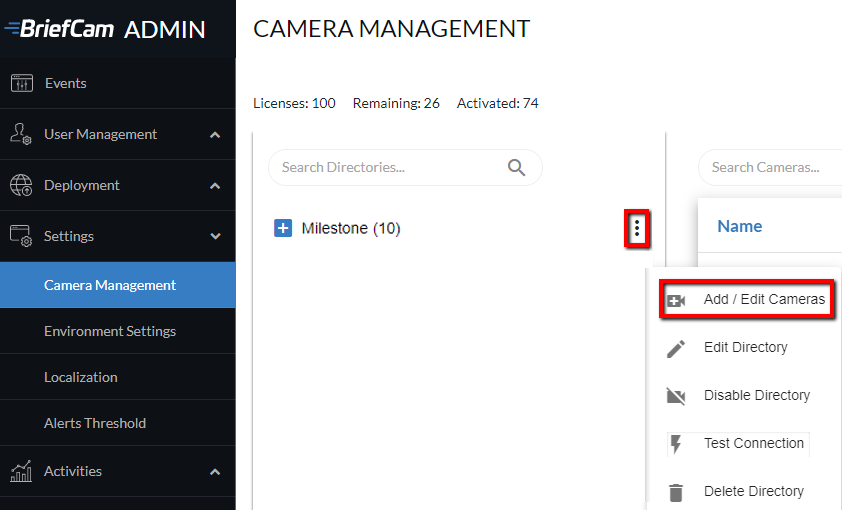

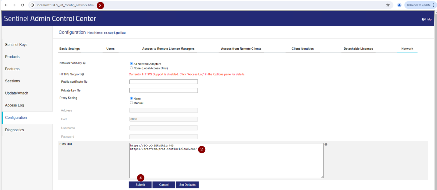

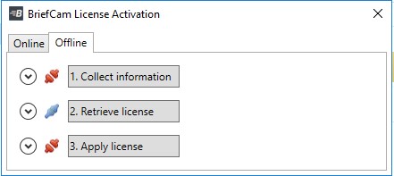

Activate licenses
This information assists you in activating an XProtect Rapid REVIEW license. You can complete activation in both online and offline modes.
It also assists you in modifying and re-activating an existing license for system expansion if, for example, you want to add additional device licenses.
All steps listed below should be performed on the server where you installed XProtect Rapid REVIEW.

  2. Navigate to http://localhost:1947/_int_/config_network.html.
  3. Add the following to the EMS URL list: https://briefcam.prod.sentinelcloud.com/.
  4. Click Submit.

Generate a C2V File
To activate the license on a server that is not connected to the internet, you first will need to generate a Client to Vendor file “C2V” from the BriefCam server.
  1. On the BriefCam server, open the BriefCam License Activation tool. By default, it is located on the desktop. If it is not on the desktop, search for it in the Start menu or you can find it in the BriefCam Server folder.
  2. Click the Offline tab to access offline activation.
  1. Click 1. Collect Information button.
  1. Select where to save the C2V file in the opened window.
  2. Copy the file to an internet-connected machine.

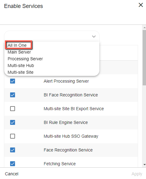

  3. From the Templates menu, select All In One.
  1. Clear the Alert Processing Server, BI Face Recognition Service, and BI Rule Engine Service check boxes (these options will not be needed).

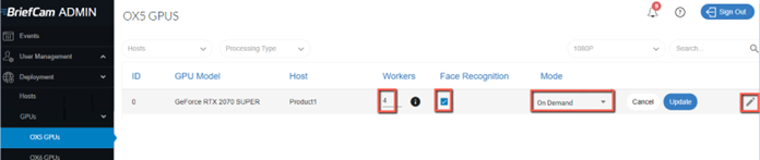

  3. From the Deployment section, click GPUs and then select GPU OX5.
  4. Click on the edit icon ().
  5. If face recognition will be used, select the Face Recognition check box.
  6. In the Mode column, select On Demand.
  1. Verify that the number of workers under Workers is set to 4.

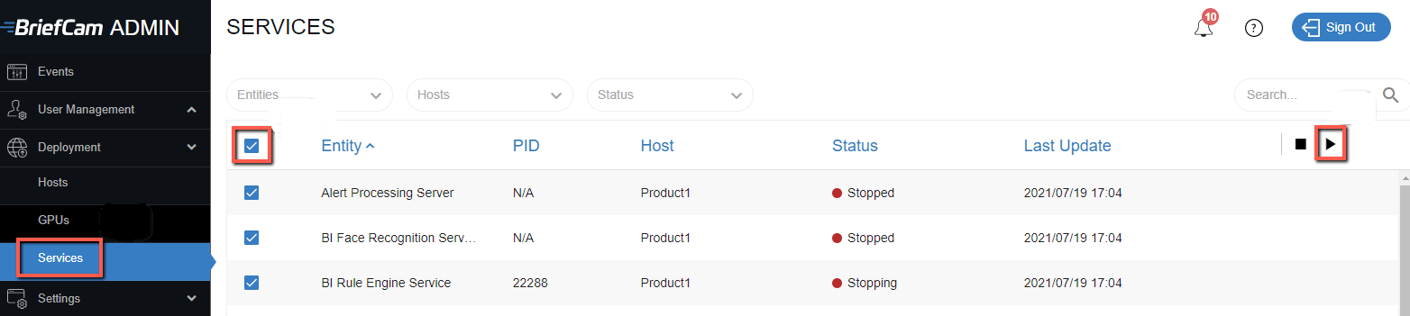

  2. From the Deployment section, click Services.
  3. Select the check box at the top left of the table.
  4. Click the start button.

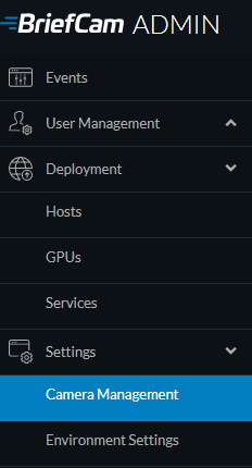

STEP 3 – Define and activate the cameras
  1. Open the Settings section and click Camera Management (as shown in the image below).
  1. Click Add directory. The Add Directory dialog box opens.
  1. From the Video Integration field, select Milestone Integration.
  1. In the Directory Name field, enter a display name for the user directory.
  2. In the Address field, enter the IP address of the Milestone VMS server.
  3. In the User Name and Password fields, enter an administrator user name and password of the VMS server. With an admin user you can make sure that all the cameras can be accessed.
  4. Click Add to add the directory.
  5. Click the zoom () icon to the right of the new directory and select the Add / Edit Cameras option.

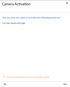

  6. For all of the cameras, select the check box in the camera’s Activated column and click the Activate button (located in the bottom right corner), as shown in the image below.
  1. The Camera Activation pane shown below will appear. If you are sure you want to activate the cameras, click Yes. Note that Camera activation is irreversible. It cannot be reset unless a special approved request is opened with BriefCam support.

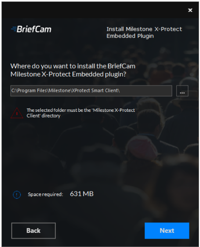

  1. Select the installation destination path and click Next.
    Note that the installation path must be the same directory where Milestone XProtect Smart Client is installed. (This may vary slightly between client computers and between Milestone versions.)
  2. Select XProtect Rapid REVIEW and click Next

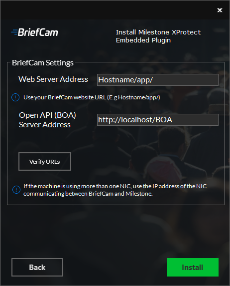

  1. Enter the BriefCam Web Application URL (which is the hostname or IP address of the BriefCam computer followed by /app and verify that the provided URL is correct by clicking the Verify URL button (as shown below).
  1. In the BriefCam Open API (BOA) Server Address field, enter the hostname or IP address of the BriefCam computer followed by /BOA.
  1. Click Next.
  1. Click Install and then click Finish.

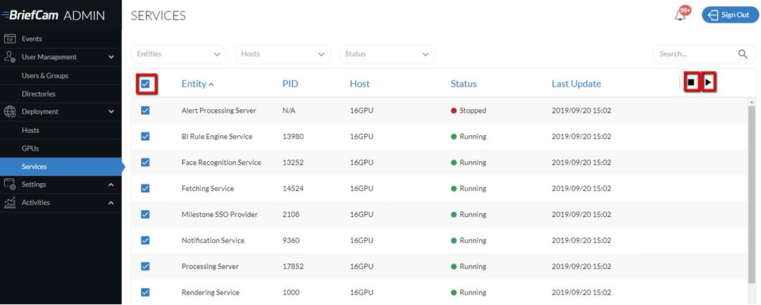

  2. In the BriefCam Administrator Console, restart the services by selecting all of the services, clicking the stop button () and then the start button (), as shown in the image below.

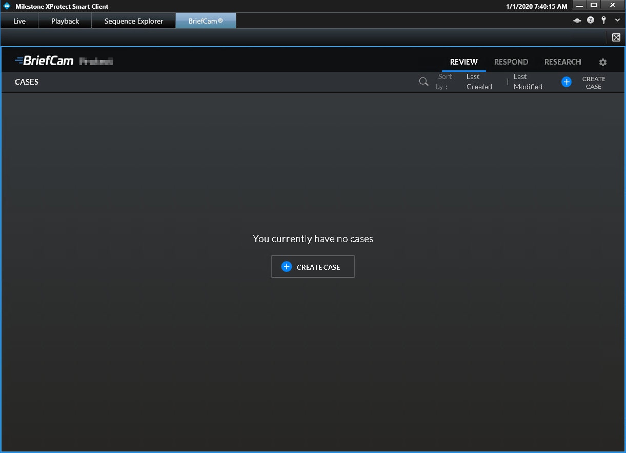

When you have completed the steps, a BriefCam tab will appear in the Milestone XProtect Smart Client.

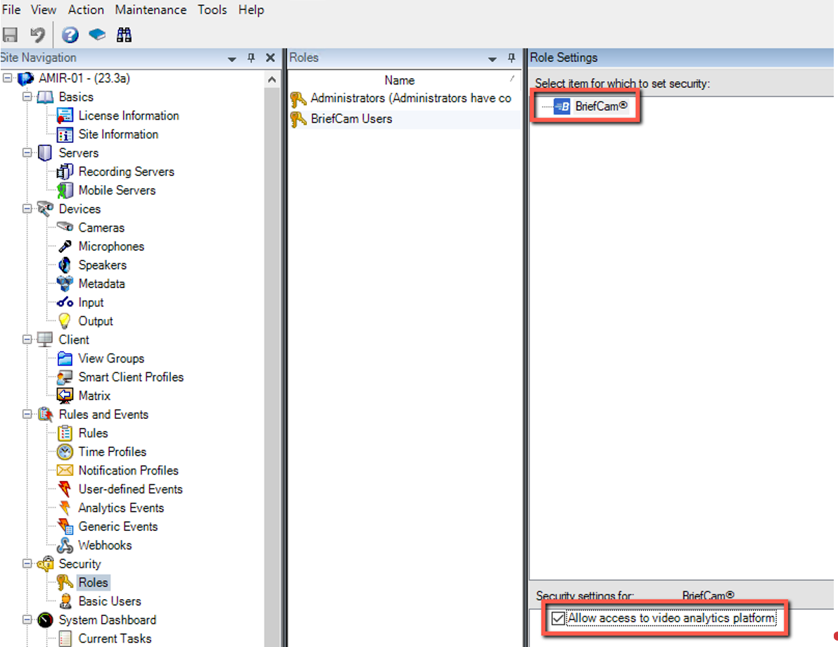

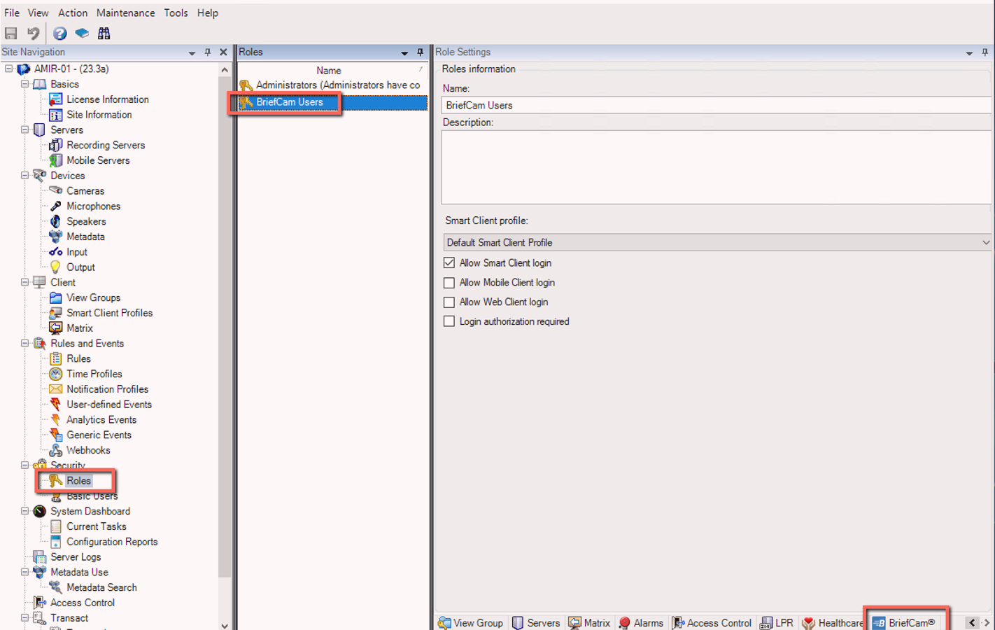

  5. Log into the Milestone XProtect management client.
  6. Right-click on the Roles section and add a new role, for example: BriefCam users as shown in the image below.
  7. Make sure that the new role is selected and click the BriefCam tab at the bottom of the screen. In the management client in Milestone XProtect 2023 R1, the tab is named MIP.
  8. From the Role Settings section, select the BriefCam role, as shown in the image below.

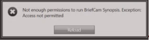

  9. Give these users access to BriefCam by selecting the Allow access to video analytics platform checkbox.
If the check box is not selected, the user will see the following message when clicking the Rapid REVIEW tab. If the check box is not checked, the user will see the following message when clicking the Rapid REVIEW tab.

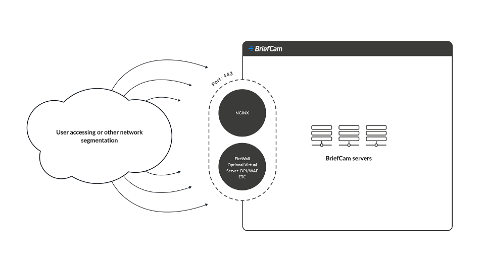

To work with SSL and BriefCam, using a load balancer is required.
This section describes the steps to take to use the NGINX load balancer as an https host for BriefCam services. BriefCam recommends using NGINX.
Recommendations
  • It is recommended to use NGINX. You’ll find BriefCam’s NGINX plugin in theXProtect Rapid REVIEW zip file.
  • If you are working in a virtualized environment, the load balancer must be on a separate machine.
  • If you are working in a non-virtualized (physical servers) environment, you can have the load balancer on the same machine as the Web Services (although it is not recommended). However, if you install the load balancer on the same machine as the Web Services, IIS has to work on a different port than 80, since 80 is for NGINX.

  1. To run BriefCam's NGINX Installation wizard, right-click on the BriefCamNGINX_<Version number>.exe file and select Run as administrator.
    If you are using the latest Windows Update and a Windows Defender alert appears, click the More info link and click Run anyway.

  5. Enter the IP address or the hostname (if there is a DNS resolution) for each of the relevant services below, and click Next.

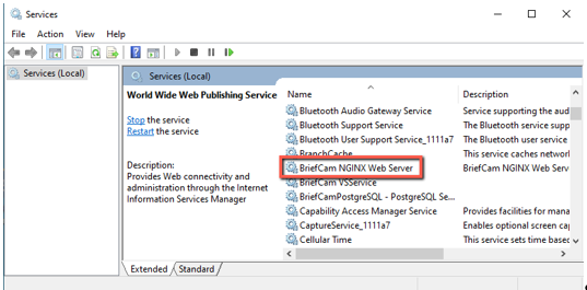

NGINX Windows Service
The BriefCam NGINX installer creates a BriefCamNGINX Web Server service in the Windows Services screen. This service is responsible for making sure the NGINX process is constantly running and the load balancer is ready to accept requests.

  3. Create an OS user (such as bcuser), a user on the OS level, or create a Windows user account. The user does not need admin rights.
  4. Edit the C:\NGINX folder’s security options and assign full control to the user that you created in step 3.
  5. Click Start (Windows key) and type secpol.msc to open the Local Security Policy utility.

  • The network segment hosting the BriefCam servers / virtual computers should be separated from other networks by a firewall and access should be granted only via ports configured in NGINX. For additional information, see the Using an HTTPS Host.
  • Administrative access to the servers, such as RDP, should be allowed either over VPN or from administration bastion hosts. A bastion host is a server that allows access to a private network from a public network, such as the internet. Bastion hosts are vulnerable to potential attacks and should be kept as secure as possible.
  • If DPI / WAF/ URL protection are required – they should be implemented on the firewall when pointing to the operational BriefCam NGINX host.

  1. Select the UPGRADE option on the installer screen as shown below.
  2. Using this installer to upgrade XProtect Rapid REVIEW, you can only upgrade from version 6.4 and above:

  8. In the BriefCam Administrator Console, restart the services by selecting all of the services, clicking the stop button and then the start button, as shown in the image below.
  9. Restart IIS (by opening the Windows services, right-clicking on the World Wide Web Publishing Service and clicking Restart).
