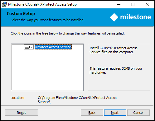

                                    At the Custom Setup step of the wizard choose to install the CCure XProtect Access Service.

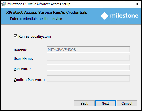

                                    At the XProtect Access Service RunAs Credentials step, the default option of Run as LocalSystem is used, or remove this option to enter a user name and password for the service. Click Next to continue.
