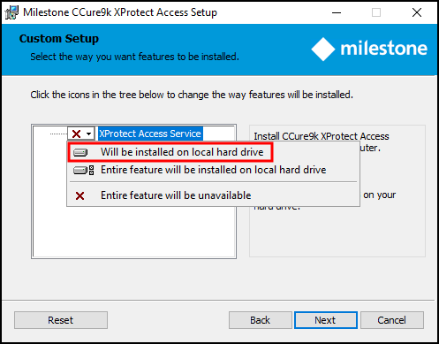

  1. At the Custom Setup step of the wizard expand the XProtect Access Service option and select Will be installed on local hard drive to install the CCure XProtect Access Service.
By default, none of the components of the integration will be selected for install. Also, there may be other components listed as available to install at this step. The XProtect Access Service component is the only one that should be installed.
