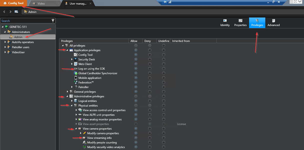

The following privileges are required on the Genetec side to connect to BriefCam:
To be able to connect:
Application privileges -> Log on using the SDK
To retrieve a list of cameras:
Administrative privileges -> Physical entities -> View camera properties -> View streaming info
For live streams:
Action privileges -> Cameras -> View live video
For fetching:
Action privileges -> Cameras -> View playback -> Export video
For alerts:
Administrative privileges -> Alarm management -> View alarm properties -> Modify alarm properties -> Add alarms
Action privileges -> Alarms -> Trigger alarms
Administrative privileges -> System management -> View user properties
Administrative privileges -> System management -> View server properties

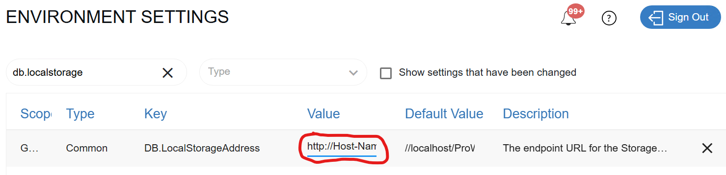

  1. When installing the Genetec plugin, in the Genetec SDK Path field, enter the path to the SDK listed in the table above for your version of Genetec. Use the second Genetec v5.7 SDK path for the 5.7 SR6 SDK. The plugins that do not have sep in the name have slightly different names for these fields.
  2. After the installation is completed, open the BriefCam Administrator Console.
  3. In the DB.LocalStorageAddress environment setting, add a prefix, either http: or https: to the value.

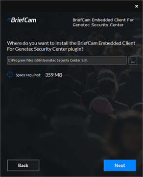

The following section describes the installation and configuration that need to be performed to allow the BriefCam web client application to become embedded in the Genetec Security Desk Application.
After installing the Genetec plugin and the relevant SDK on the BriefCam Server, you are ready to install the Genetec Embedded Client.
  1. On the same computer where the Genetec Security Desk Application is installed, run the Embedded Integration Plugin Installation by right-clicking the BriefCamEmbeddedClientForGenetecSecurityCenter_7.0.xxx.exe file and selecting Run as administrator.
  2. The installation checks for prerequisites. If anything is missing, you will be prompted to install the missing prerequisites and click Install.
  3. In the Welcome screen, click Get Started.
  4. Read and accept the License Agreement terms and click Next.
  5. Select the installation destination path and click Next.
    Note that the installation path must be the same directory where Genetec Security Desk Application is installed.

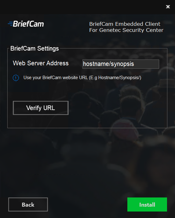

  6. In the Web Server Address field, enter the BriefCam Web Application URL. For https environments, add https:// to the beginning of the URL.
  7. Change the word synopsis to app.
  8. Verify that the provided URL is correct by clicking the Verify URL button (both IP address or hostname values can be specified).
    The URL will be saved in BriefCam.GenetecEmbeddedViewer.dll.config, which is located by default in C:\Program Files (x86)\Genetec Security Center x\Plugins\BriefCam.
    Once the installation is complete, the URL configuration can be modified manually as needed.

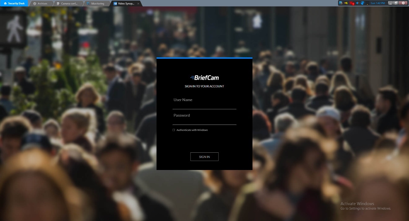

To establish a connection from the BriefCam client embedded in the Genetec Security Desk Application to the BriefCam Server:

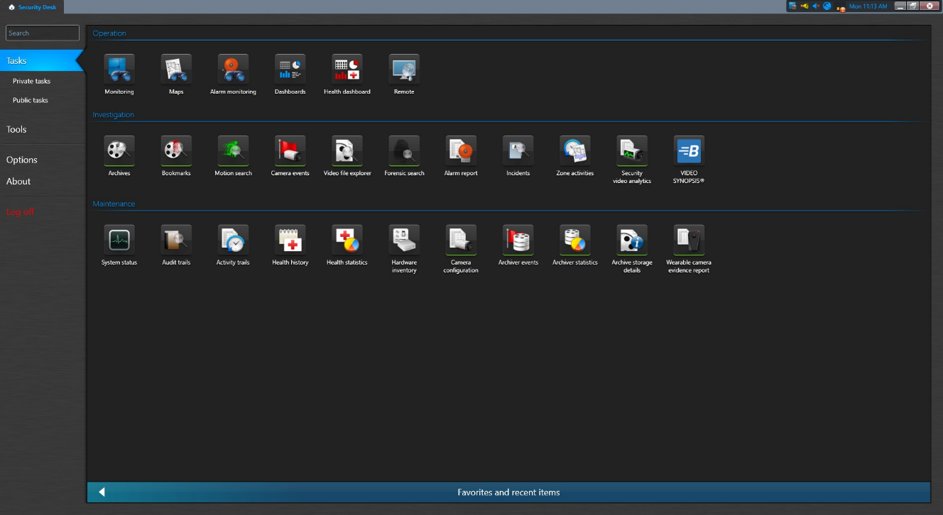

  1. Launch the Genetec Security Desk Application and log in to the Genetec server.
  2. Once it is up and running, access the Genetec Security Desk main Tasks view. A VIDEO SYNOPSIS icon for an embedded BriefCam client will appear under the Integration section. Click the VIDEO SYNOPSIS icon to access the embedded BriefCam client in a separate application tab.
  3. You will be asked to log into BriefCam upon clicking the VIDEO SYNOPSIS icon. Enter your username and password and click Sign In.

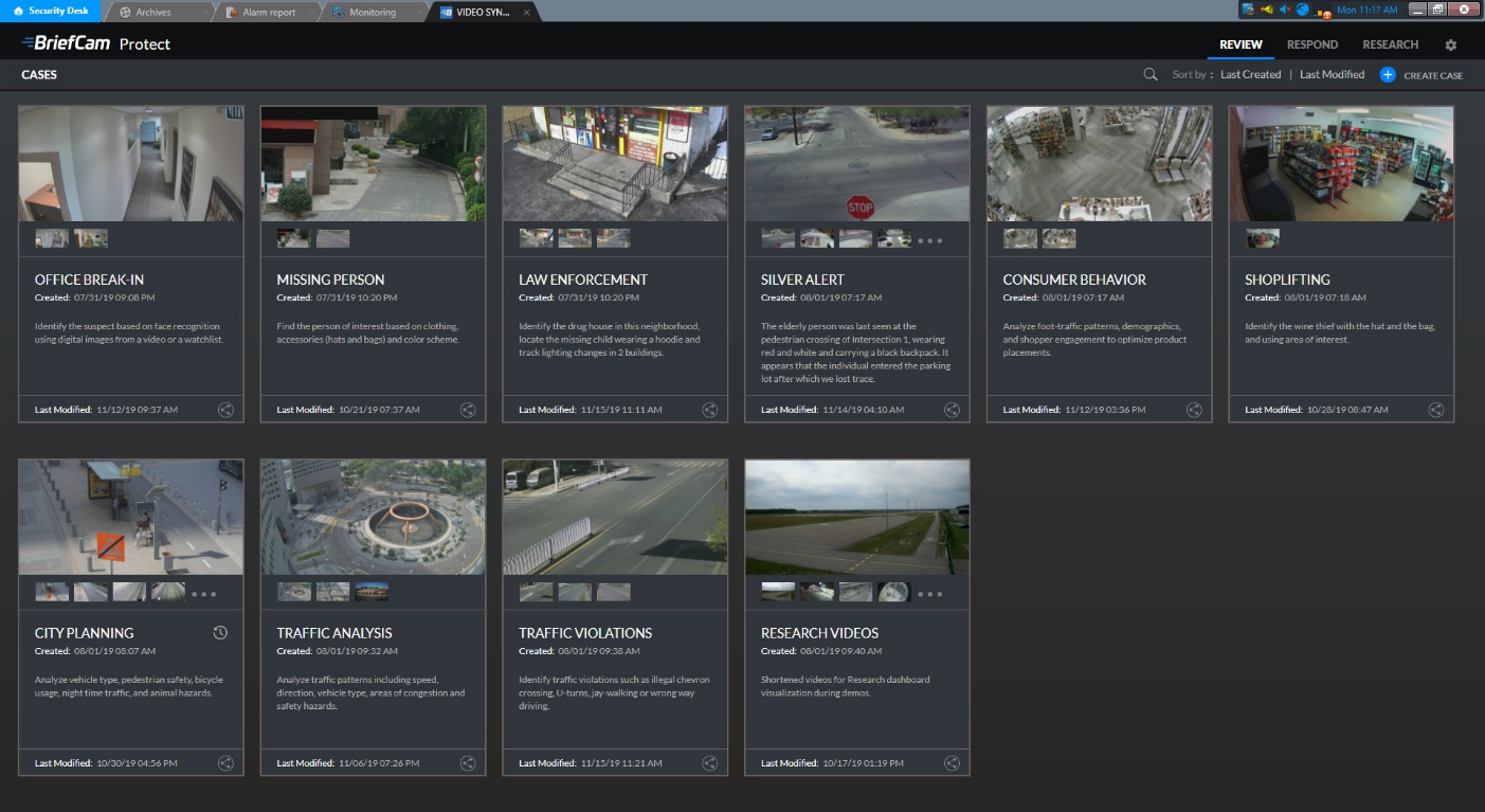

  4. Upon logging in, the embedded BriefCam client will appear within the Genetec Security Desk application’s VIDEO SYNOPSIS tab.

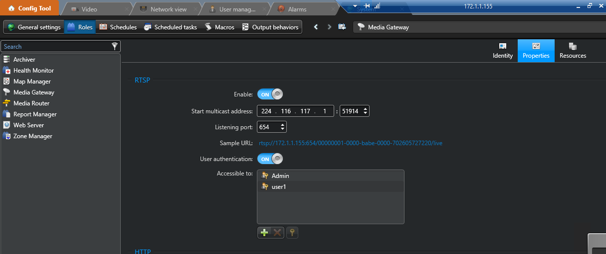

To pull real-time streams from Genetec to create alerts in BriefCam:
  1. Make sure that the Genetec portal is configured to enable RTSP and that the authentication is on.

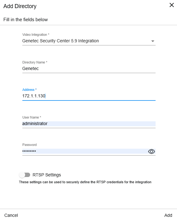

  2. In the BriefCam Administrator Console, when adding a directory, you need to enter the following information:
    • Video Integration – Select the Genetec integration you will be using.
    • Directory Name – Enter a name for the directory. The name will be displayed to the end users when selecting cameras.
    • Address – Enter the address of the Genetec directory server (host name or IP address).
    • User Name – Enter a user name that will be used to authenticate the Genetec directory.
    • Password – Enter the password for the user above.
      Note that RTSP-based integrations do not work when user’s credentials include the @ sign.
    • RTSP Settings – Turn on this toggle. Since the RTSP’s User authentication is on, you need to enter the RTSP credentials. The RTSP user name, password and address will be used for authentication to the RTSP server.

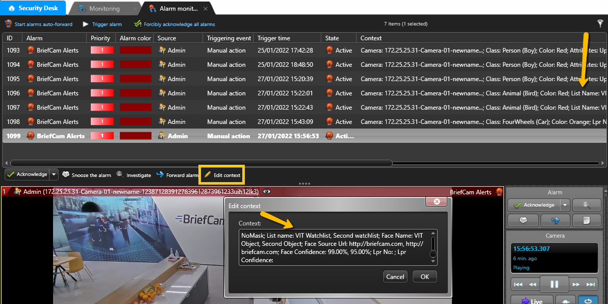

If Genetec Auxiliary Archiver is configured on the VMS and BriefCam is configured to connect to it, then every request from the VMS will automatically fetch video from the auxiliary archiver. If you want to connect to Genetec Auxiliary, make sure to edit the BriefCam.GenetecSc52Fetcher32.ini file, which is located by default at C:\Program Files\BriefCam\BriefCam Server\32\plugins – Set the ;UseAuxiliaryArchiver = false parameter to true, uncomment the line and save the file.

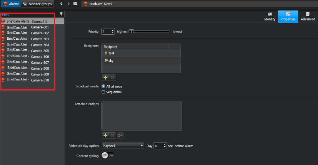

Alerts can be sent to Genetec Security Center’s Alarm monitoring tab.
The following information is sent to Genetec:
  • Camera Name
  • Class
  • Color
  • Person Attributes (Upper Wear, Lower Wear, Bag, Hat, Mask)
  • Watchlist
  • Face Recognition/License Plate Recognition Identity Name
  • Confidence
On the Genetec-side you need a full admin user.

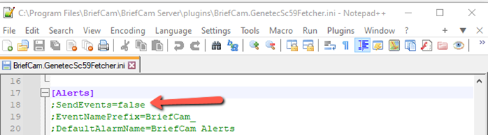

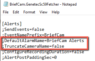

In the Environment Settings section, there are three settings relevant for sending alerts outside of BriefCam (see the image below):
  1. To send alerts outside of BriefCam, set the Respond.AlertsPublishingEnabled setting to true.
  2. To send alerts to a VMS, check that the Respond.AlertsPublishingToVMSEnabled setting is set to true.
  3. To change the polling interval, use the Respond.AlertsPublishingIntervalInMilliseconds setting.
  4. If you make changes to the settings, you need to restart or start the VSServer service.

  • DefaultAlarmName – This parameter is used as the connection between BriefCam and Genetec.
  • TruncateCameraName – This parameter lets you send a unique alarm identifier for each camera.
If the TruncateCameraName parameter does not exist in the .ini file, the default behavior will be as if the parameter is set to false. If the parameter is set to true, every alarm sent to Genetec will have the following identifier:
<DefaultAlarmName> - <Camera name> for example: BriefCam Alarm - Camera-55.
Note
If you expect a large number of alarms to occur simultaneously, set the ReactivationThresholdSec parameter to 0. This ensures that no alerts are missed.
You can send events instead of alerts. You do this by setting the SendEvents parameter to true and uncommenting the row by removing the semicolon (;). The parameter is in the BriefCam.GenetecSc58Fetcher.ini file or the BriefCam.GenetecSc59Fetcher.ini file, which is located by default at: C:\Program Files\BriefCam\BriefCam Server\plugins.
