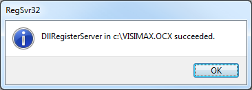

  4. Enter Regsvr32 <full path to the location where you put visimax.ocx> (i.e. Regsvr32 C:\VISIMAX.OCX).
  5. A pop-up window will indicate that the registry has been added successfully. Click OK.

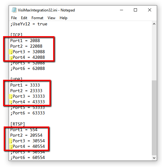

    2. When a VisiMAX server has more than two ports (two instances), you need to enable additional ports in the file by uncommenting the ports (removing the semicolon) in the TCP, UDP and RTSP sections of BriefCam’s VisimaxIntegration32.ini file (located at: C:\Program Files\BriefCam\BriefCam Server\32\plugins).
      For example, if the VisiMAX server is using four ports, find ports 3 and 4 in the file and uncomment them (remove the semicolon) in all sections.
      Enabling an offline port will significantly slow down the connection process.
