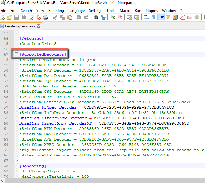

  5. There might be an issue with the fetching or decoding.
    An issue with decoding could be one of many things. But, in general, if there is an issue with decoding then files/requests might fail processing. For decoding, you can look at the RenderingService.ini file’s SupportedDecoders section.
