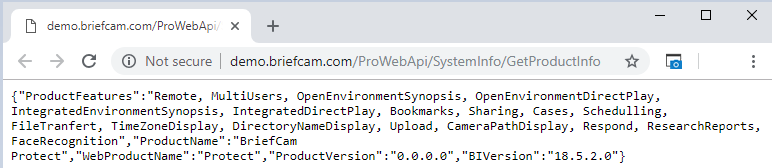

  3. Perform a sanity check to see that the web services are working by entering this URL in the browser:
    http://[BriefCam server’s address]/ProWebApi/SystemInfo/GetProductInfo.
  4. A JSON response is returned. If you receive a screen similar to the one below (with the product features, license, etc.) you’ll know that the web service is responding with the activated license.

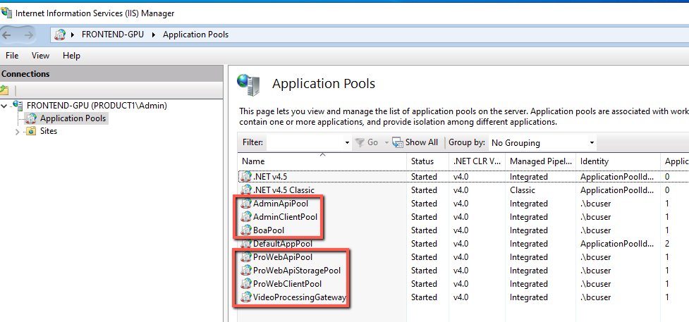

  9. The IIS Manager manages all BriefCam web services. Make sure that the status of the application pools marked below in red are all Started. If you had to start any of them, restart IIS. If one of them is stopped, you will get a “service unavailable” error.

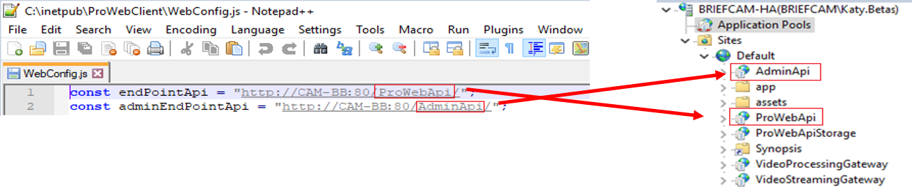

  10. Check that the values in the WebConfig.js file match the names of the Application Pools’ Sites.
