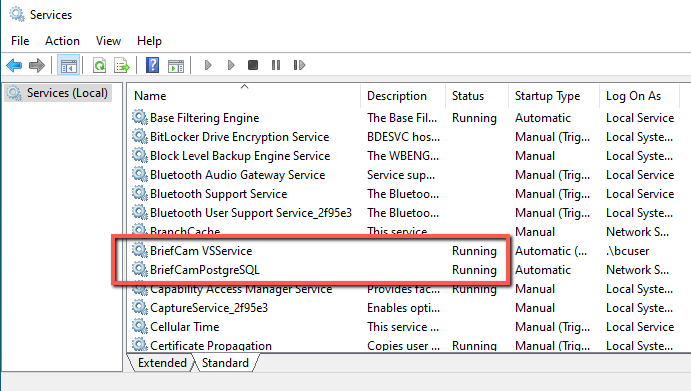

From services.msc, check that the BriefCam VSService and BriefCamPostgreSQL services are running.

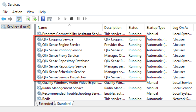

If you are using the RESEARCH module, check also that the Qlik services are running.

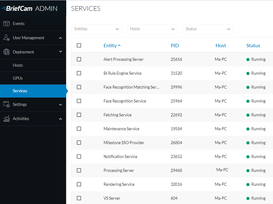

Check that the relevant services are running (in the BriefCam Administrator Console) and check that the Process ID (PID) is not changing.

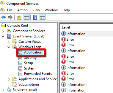

If there is a BriefCam error, check if the System/Application logs of the Event Viewer have errors with the same or similar timestamps as the BriefCam logs.
To launch the Event Viewer, from the Start menu, type Event Viewer into the search box.
