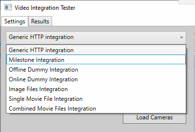

  1. Run the Video Integration Tester (VIT) from: C:\Program Files\BriefCam\BriefCam Server\VideoIntegrationTester.exe.
  2. From the drop-down list, select the integration that you want to test.

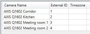

  3. Enter the address of the server, the server’s user name (such as admin), the user name’s password (if there is one), and click the Load Cameras button.
  4. See that your camera list is populated.

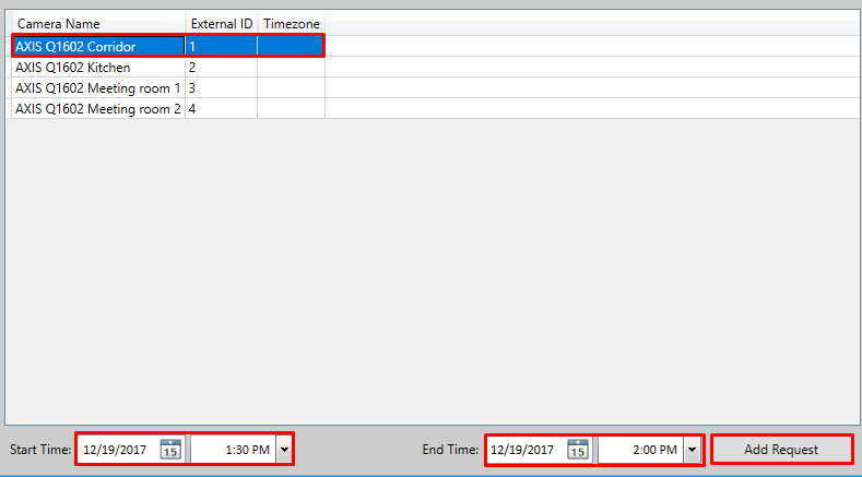

  5. Select a camera, set the start/end times, and click the Add Request button.
  6. Check the results in the Results tab.
