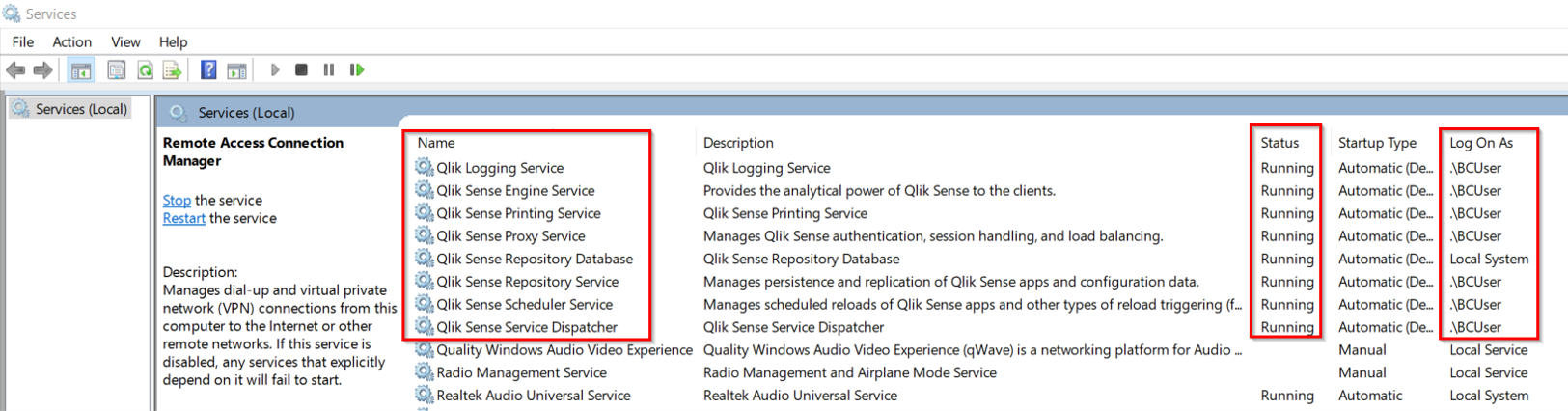

BriefCam uses Qlik Sense technology to display dashboards in the RESEARCH solution. Check that the Qlik Services are running.
