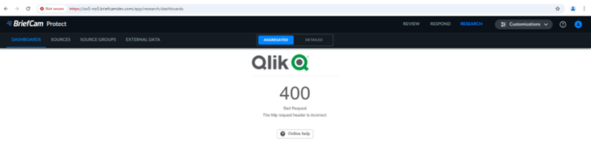

When accessing RESEARCH dashboards, why am I receiving a 400 error page with the error message "incorrect header"?
