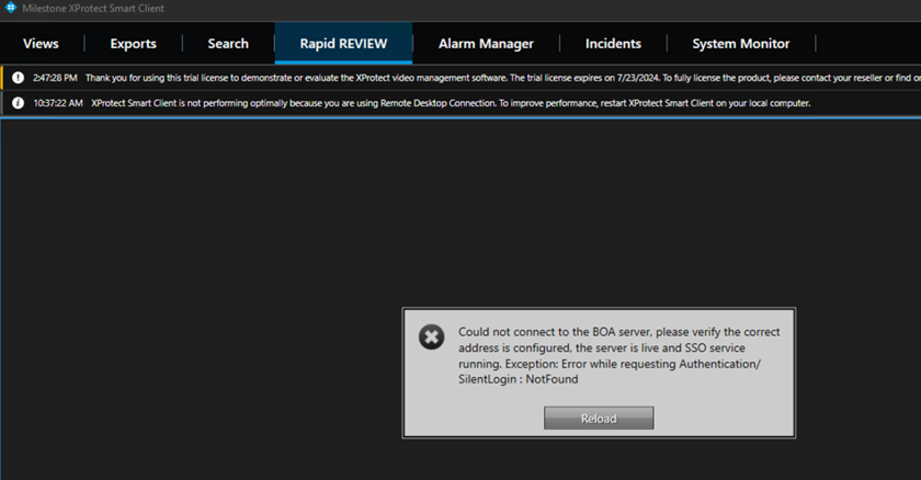

BriefCam (or XProtect Rapid REVIEW) was installed without any errors. However, the Milestone embedded client shows one of these messages:
  • The embedded client could not be launched
  • The BriefCam server is unreachable
  • Could not connect to the BOA server

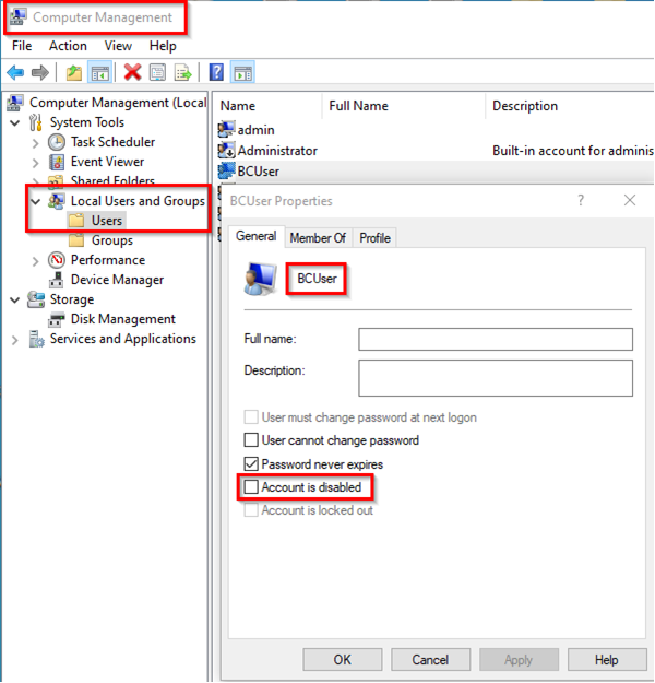

    Note that by default the user who runs the BriefCam services is the BCUser. You may still see the white screen issue if the user configured as BCuser was disabled, for example, after moving to a domain. To solve this issue:
  3. From the Windows Services, try restarting the BriefCam VSService.
  4. If the service fails to start, then check the BCUser settings in the Computer Management console.

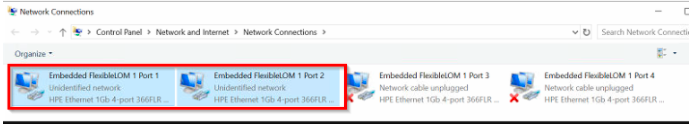

  1. Check how many activated NICs exist, by going to Control Panel > Network and Sharing Center > Change adapter settings.
  2. If there is more than one NIC activated, if possible, inactivate one of the NICs.

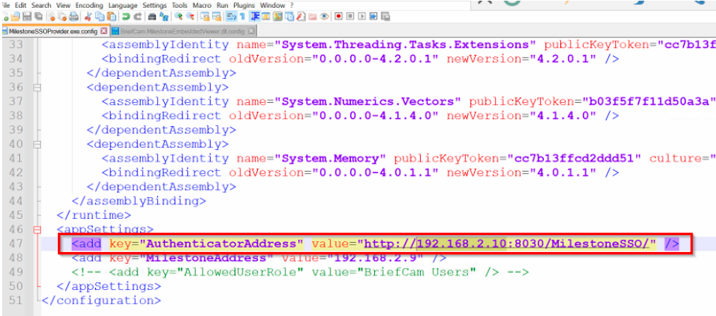

  1. On the BriefCam server, open the MilestoneSSOProvider.exe.config file (located at: C:\Program Files\BriefCam\BriefCam server) and find the AuthenticatorAddress value.
  2. If the value is set to localhost, change the value to the BriefCam server’s IP address.

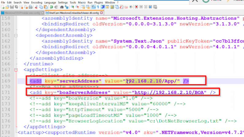

  3. On the Milestone smart client machine, open the BriefCam.MilestoneEmbeddedViewer.dll.config file (located at: C:\Program Files\Milestone\XProtect Smart Client\MIPPlugins\BriefCam).
  4. If the value of the serverAddress or boaServerAddress key is set to localhost, change the values to point to the BriefCam server’s IP address.

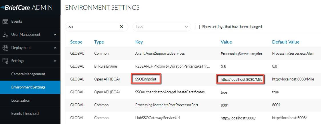

  5. In the BriefCam Administrator Console, go to Settings > Environment Settings and search for the SSOEndpoint setting. If the value is set to localhost, change it to the BriefCam server’s IP address, that is: http://[BriefCam server IP address]:8030/Milestone

If you see the “Could not connect to the BOA server. Please verify the correct address is configured. The server is live and SSO service running. Exception: Error while requesting Authentication/SilentLogin: Not Found” error, you’ll need to manually configure SSO-related settings making sure that each of the config file's settings are pointing to the proper server hostname (either to the BriefCam Administrator Console server or to the Milestone server).
  1. In the BriefCam Administrator Console, go to Settings > Environment Settings and search for the SSOEndpoint setting. If the value is set to localhost, change it to the BriefCam server’s IP address, that is: http://[ BriefCam server IP address ]:8030/Milestone

  4. Open the BriefCam.MilestoneEmbeddedViewer.dll.config file (located at: C:\Program Files\Milestone\XProtect Smart Client\MIPPlugins\BriefCam), both the serverAddress and the boaServer address need to point to the BriefCam server. If there is more than one NIC, use the IP address of the BriefCam server. Below are detailed instructions of how to do this:
    1. Scroll to the bottom of the file and look for the following lines: <add key=”serverAddress” value=”http://machine’s_hostname/app/” />
    2. Change the values to match your BriefCam server (the XPRR machine). For example, if the BriefCam XPRR machine is called RapidReview, the value will look as follows: http://RapidReview/app/
    3. Find this row: <add key=”boaServerAddress” value=”http://machine’s_hostname/BOA/” />
    4. Change the value point to your BriefCam server. For example: http://RapidReview/BOA/
