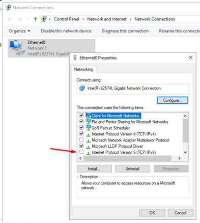

  4. On the Windows server, disable IPv6 on the Network interfaces.

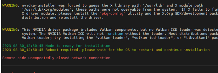

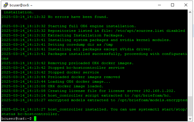

  3. The yellow texts are warnings and the red texts are errors that you must correct before continuing. If you receive the following warning, rerun the script.
    If the script fails with this error: Local time in <TIME> and BOA server time do not match, verify that the NTP servers are reachable, run the following command: systemctl restart systemd-timesyncd.service to restart the time sync service, and rerun the script.
    If you see any other red error, do not proceed with the following steps and contact BriefCam Support.
    When the prerequisites check is successful, you’ll see the following:

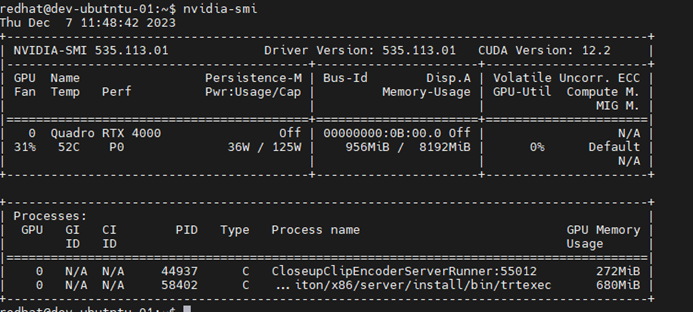

  4. The server will reboot during the process. Once the server has been rebooted, you can use the nvidia-smi command to verify that the NVIDIA driver is properly installed and the GPU is accessible to the operating system (as seen in the image below).

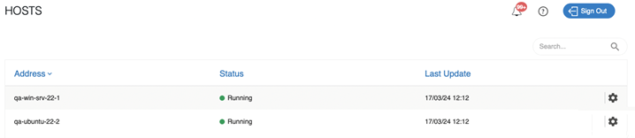

  1. Log into the BriefCam Administrator Console. From the Deployment section, open the Hosts screen.
    Note
    If you do not see the Linux host in the table, log out, clear the browser cache, and log in again.

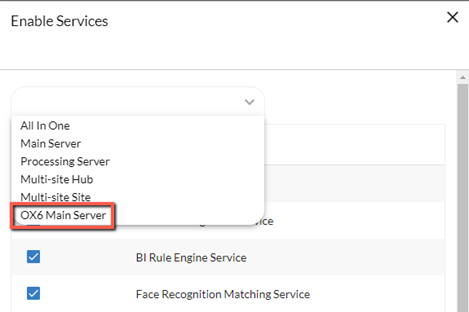

  2. For the Windows host, click on the settings icon and select the OX6 Main Server template.
    This will select all the relevant services, including the five OX6 services:

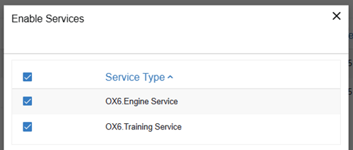

  3. For the Linux host, click on the settings icon and select the OX6.Engine Service and the OX6.Training Service.

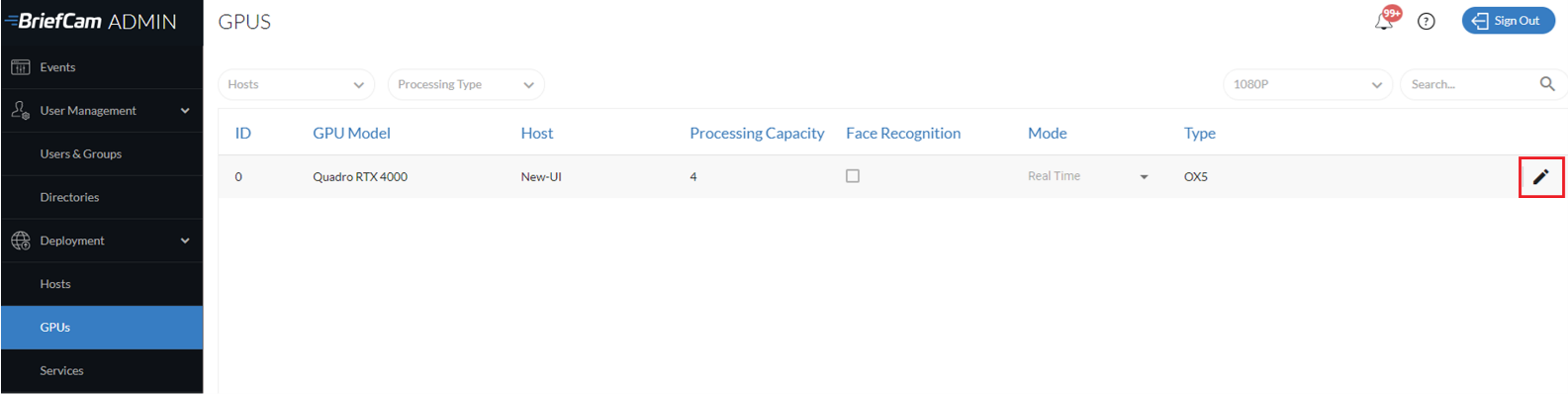

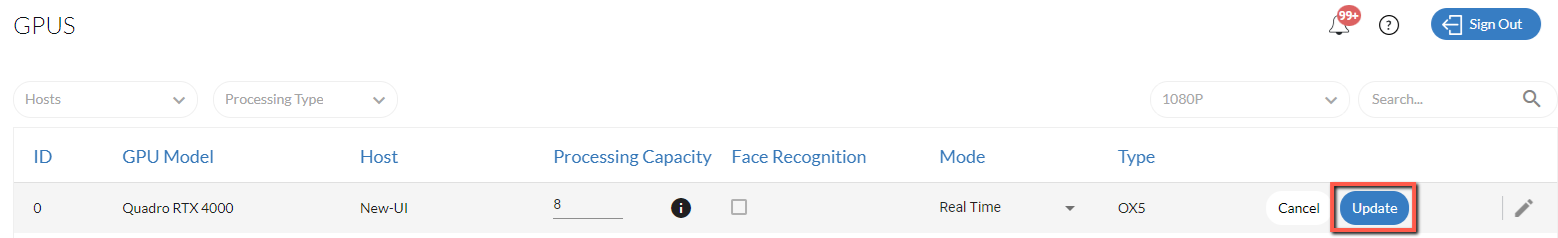

  4. Open the GPUs section.
  5. Click the edit button.
  6. Configure the Processing Capacity using the table below (for 1080p cameras, 15 FPS, and medium activity). Find the GPU that best describes your environment and copy the value from the Real-time channels column into the GPUs screen’s Processing Capacity column.
    Engine
    GPU
    Real-time channels*
    Windows-based OX5
    Ampere A10
    30
    Ampere RTX A2000
    23
    Ampere RTX A4000
    30
    Ada RTX4080 (for laptops only)
    28
    Ada L4
    30
  7. Set the Mode column to Real Time.
  8. If you edit the GPU entry, click the Update button. When you click this button, the updated settings are pushed to the Next-Gen server.

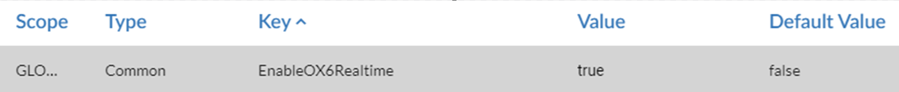

  9. Make sure that the EnableOX6Realtime environment setting is set to true.

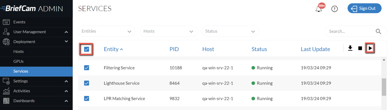

  14. In the Services section, start all the services.

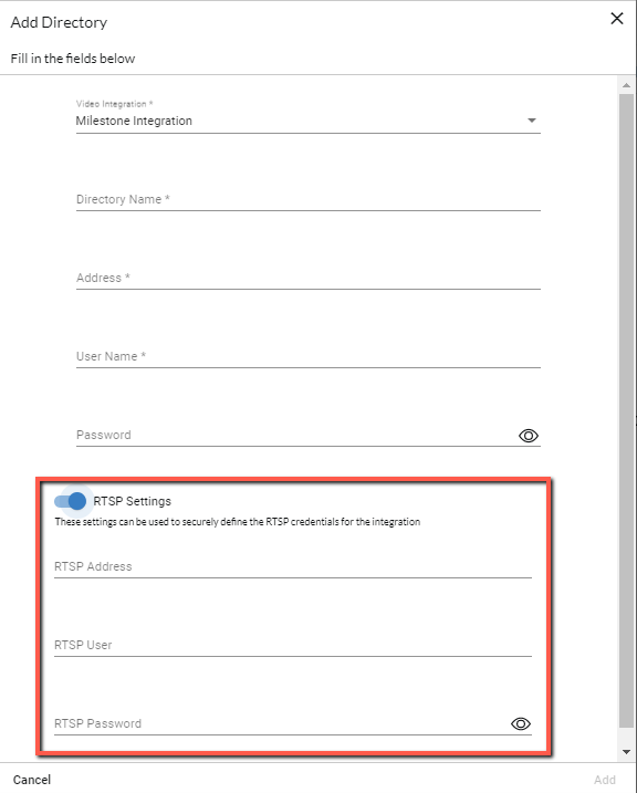

  15. Add the VMS directory as follows:
    1. Open the Camera Management section.
    2. Click the Add Directory button.
    3. From the Video Integration field, select the appropriate VMS integration option. Different integrations can be added by installing additional VMS-specific plugins.
    4. In the Directory Name field, enter a display name for the user directory.
    5. In the Address field, enter the VMS server’s IP address. If you are not using the default port (80), add the communication port (the port number may be specified as a suffix to the address, preceded by a colon).
    6. In the User Name and Password fields, enter the VMS server user name and password. This user must have permissions in the VMS to the cameras exposed for BriefCam.
    7. Click Add to add the directory.
    8. For Milestone and Genetec integrations, scroll down and enable the RTSP Settings option.
    9. Set the RTSP IP address, user name, and password. The RTSP user name and password can be different than the user name and password of the VMS.
