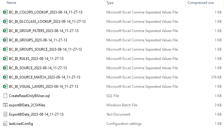

Below is an example of the files that are exported.
The CSV files that are exported are:

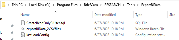

On the machine where RESEARCH is installed, open the folder:
C:\Program Files\BriefCam\RESEARCH\Tools\ExportBIData. In this folder you will find the files that you need to export BriefCam’s RESEARCH data.

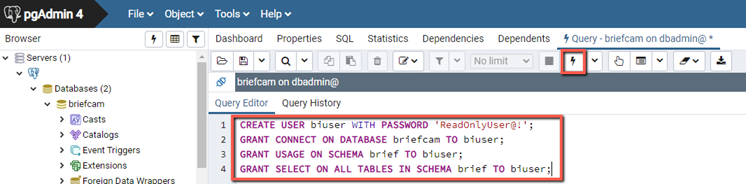

Create a BI user that will have access to read from the database (you only need to do these steps one time):

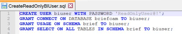

Open the
CreateReadOnlyBIUserfile and copy the SQL written in the file.

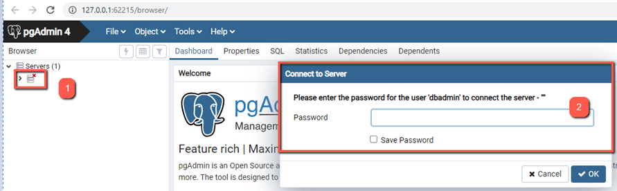

From the
C:\PostgreSQL\pgAdmin 4\binfolder, run thepgAdmin4.exefile.Connect to the briefcam server.

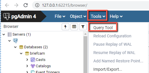

Right-click the briefcam server and select Tools > Query Tool.
Paste the query and execute it by clicking on the lightning icon.
You should now be able to see a Query returned successfully message.

A log file will be created.
The first time you run the script you will see that for each section there was a full load.
If you are running it for a second time, the script will run on any changes that occurred since the last time the script was run. You will then see in each of the sections how many items were incrementally loaded. For example, in the below log, you can see that 14,189 items were loaded since the last run.
