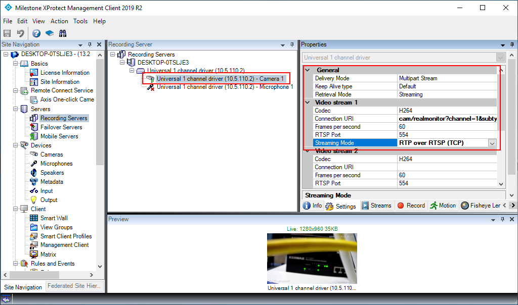

Configuring the Universal Driver
In order for the Universal driver to receive video/audio it needs to know the Retrieval Mode, URI, codec and port.

Configurations for different stream types:
RTSP/RTP over UDP |
Retrieval Mode |
Streaming |
Codec |
MJPEG, MPEG4, H264 or H265 |
Streaming Mode |
RTP/HTTP |
RTSP/RTP over TCP |
Retrieval Mode |
Streaming |
Codec |
Streaming Mode |
RTP/RTSP /TCP |
