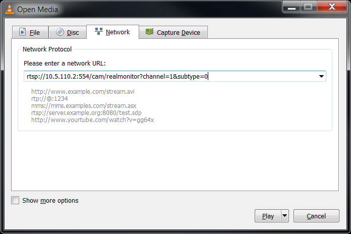

From the Media menu select “Open Network Stream” (Ctrl+N). In the text field enter the URL of the video/audio stream from the device.
You might get a prompt to enter authorization credentials. Make sure to use the same credentials also when adding the device in the Management Client.

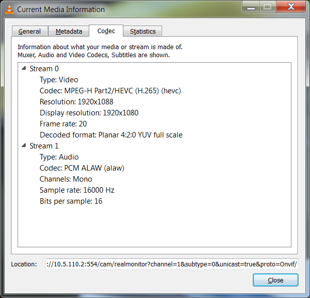

If the video/audio starts playing, verify that the codec is correct with the one set in the Management Client. To see the codec of the stream in VLC select Tools->Codec Information (Ctrl+J)

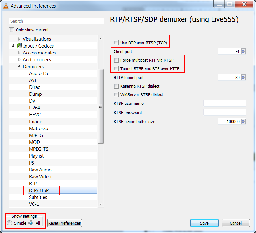

Open the VLC Preferences dialog – Tools->Preferences (Ctrl + P).
Select “All’ for “Show settings” in the lower left corner of the dialog.
If “Use RTP over RTSP (TCP)” is selected this is the same as selecting “RTP/ RTSP/TCP” for Streaming Mode in the Management Client.
If “Force multicast RTP via RTSP” is selected this is the same as selecting “RTP/UDP multicast” for Streaming Mode in the Management Client.
If “Tunnel RTSP and RTP over HTTP” is selected this is the same as selecting “RTP/RTSP/HTTP/TCP” as Streaming Mode in Management Client.
If none of the option in VLC is selected this is the same as selecting “RTP/UDP” for Streaming Mode in the Management Client.
