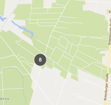

When cameras and other devices are close to each other, and you zoom out, the devices are grouped in clusters and displayed visually as circular icons. The cluster icon includes information about the number of devices inside that cluster.

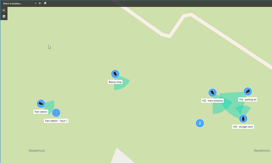

When you zoom in, for example, by double-clicking the cluster, you can see the individual devices and any sub-clusters.
