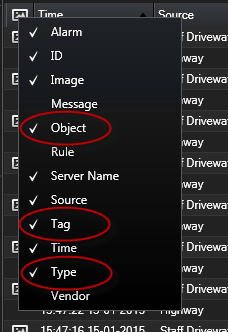

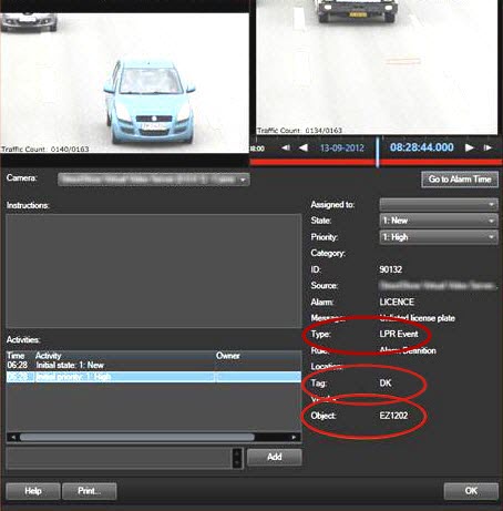

Enable LPR-specific elements
To be able to see all relevant information regarding LPR recognitions in your XProtect Smart Client, on the Alarm Manager tab, do the following:
- On the Alarm Manager tab, in the Alarms list, right-click the Image icon
next to the Quick Filters column. From the menu, select: Object, Tag, and Type.
- Now Type displays all events related to LPR, Tag displays their country codes, and Object displays license plate numbers of the registered vehicles.
