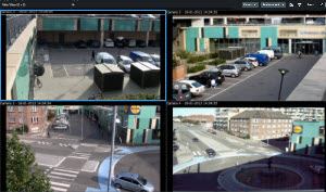

The way video is displayed in XProtect Smart Client is called a view. XProtect Smart Client can handle an unrestricted number of views, allowing you to switch between video from various groups of cameras. Views can hold between one and hundred cameras, but can also contain other types of content, for example images and text.

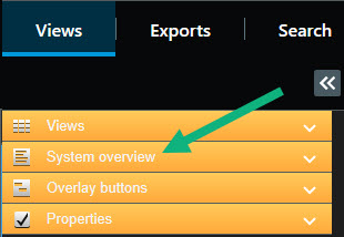

- In the System overview pane, expand the required server
to view a list of available cameras from that server.

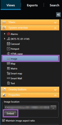

You can display static images in a view. For example, this is useful when you want to share a snapshot of a suspect, or a diagram of emergency exits.
Steps:
- Click Setup to enter setup mode.
In the System overview pane, drag the Image item to a view item. A window appears.
- Locate and then select the image file that you want to add.
- Click Open. The image now appears inside the view item.
- To make the image available to others who cannot access the location of the image file, on the Properties pane, click Embed. The file is stored in the system.
- Click Setup again to exit setup mode. Your changes are saved.
