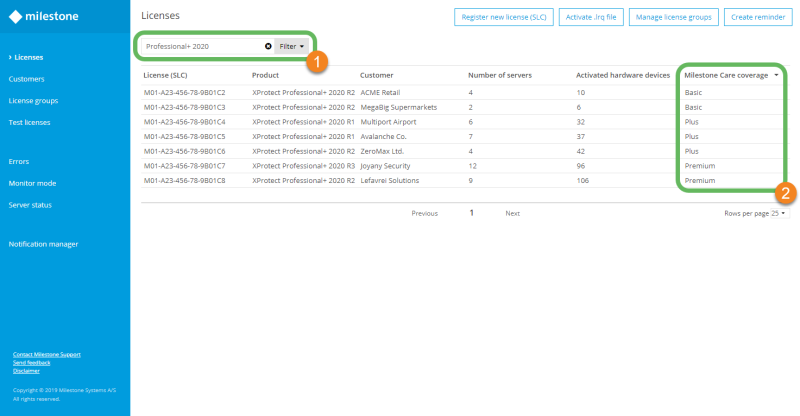

The Search field on the Licenses page lets you search for a license based on:
  • SLC number
  • VMS product and version
  • License description
  • Customer name
  • Milestone Care coverage
Select the relevant column header to sort the information alphabetically based on the selected column .
The licenses page in Milestone Customer Dashboard.

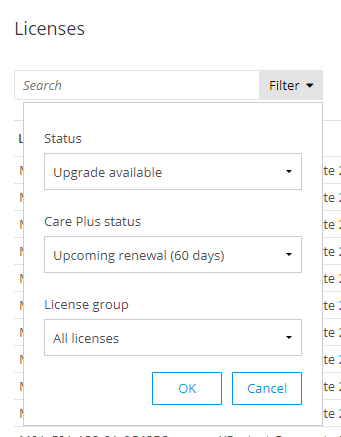

You can filter your licenses based on license status, the Milestone Care™ coverage of the license, and by license groups. With the Filter option, you can find SLCs that have Milestone Care coverage that run older software versions or will soon expire.
  1. Select Filter to view the different filter options.
  2. Select one or more filter options.
  3. Select OK.
The search filters for licenses in Milestone Customer Dashboard.
