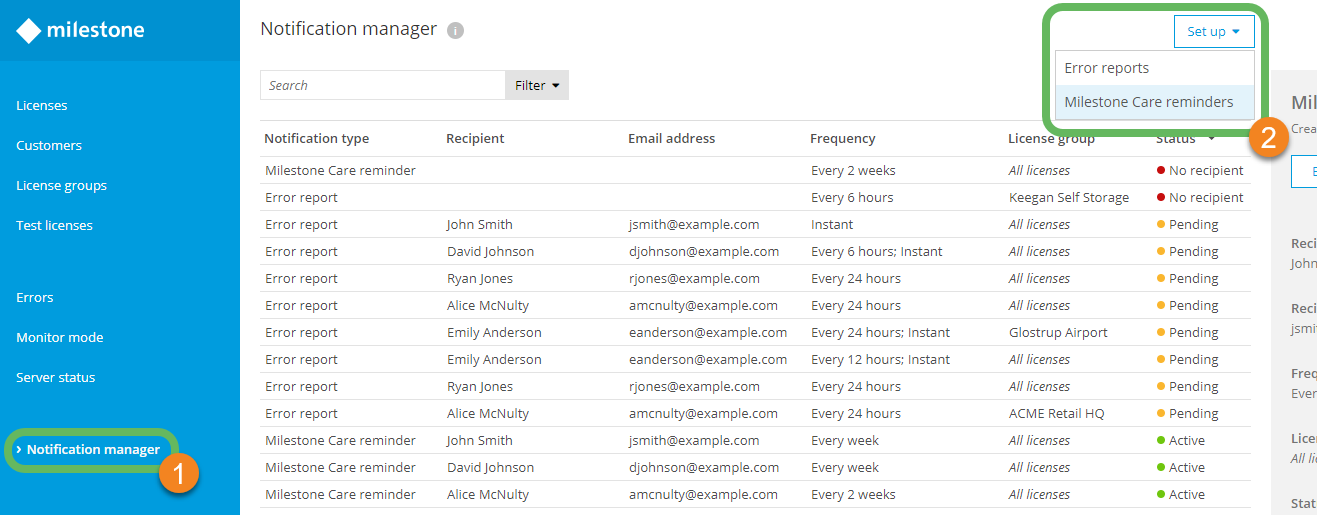

  1. Log in to Milestone Customer Dashboard (https://online.milestonesys.com/).
  2. In the main menu, select Notification manager.
  3. Select Set up > Milestone Care reminders.
    Alternatively, select Set up reminder on the Licenses page.
    The Set up menu on the Notification manager page in Milestone Customer Dashboard.

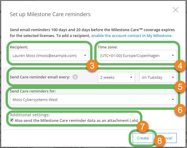

  4. In the Set up Milestone Care reminders window, in the Recipient dropdown list , select an account contact with an email address.
  5. Specify a Time zone for the Milestone Care reminder, usually the time zone where the recipient is located.
  6. Select the number of weeks and day of the week next to Send Milestone Care reminder every to specify the frequency with which the Milestone Care reminder is sent.
  7. Optional: In the Send Milestone Care reminders for dropdown list , select a license group to specify which licenses you would like to send the Milestone Care reminders for. See Grouping licenses on how to create license groups and add and remove licenses to them.
    The default All licenses selection includes all of your current licenses and any future licenses that are added to your account.
  8. Optional: Select the Also send the Milestone Care reminder data as an attachment (.xls) check box to send the expiring licenses listed in a spreadsheet file, which you can view and edit in Microsoft Excel. The data is listed in a sortable spreadsheet format that is convenient if you have a large number of expiring licenses.
  9. Select Create to create the Milestone Care reminder profile.
    The Set up Milestone Care reminders window.
