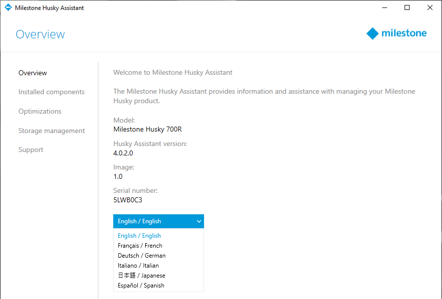

Overview
A list of details about the unit:
  • Model: Milestone Husky model
  • Version: Milestone Husky Assistant version
  • Image: Husky firmware version
  • Serial number: Refers to the service tag of the unit
You can change the language in which Husky Assistant appears.

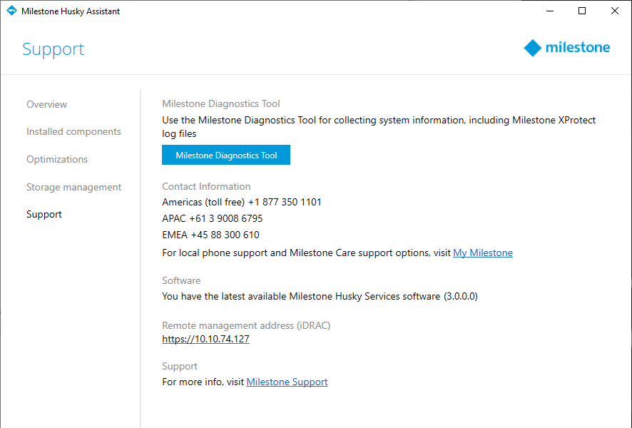

Support
Run the Milestone Diagnostics Tool to create files that are needed for the Milestone reseller when the reseller helps you troubleshoot.
Lists the information that you need to contact Milestone Support. Always contact your Milestone reseller that you have bought the unit from before contacting Milestone Support.
Shows the current version of Milestone Husky Services software.
Find the iDRAC remote management IP address.
Will only be present when the iDRAC port is connected to a network.
Choose your language
To select your preferred language:
  1. Open Husky Assistant.
  2. On the Overview tab, select your preferred language from the list of available languages.
    Husky Assistant chooses English by default. All language changes require a restart of Husky Assistant.

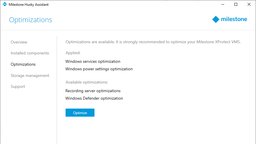

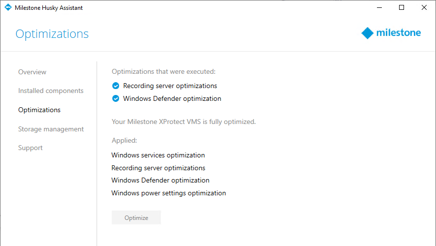

Apply optimizations
Husky Assistant can help you to optimize Windows for running XProtect software and to optimize XProtect software for running on your Husky unit. If you have installed Milestone XProtect VMS without using Husky Assistant, you need to apply the available optimizations. To check if any optimizations are available:
  1. Select the Optimizations tab.
  2. A list of the available optimizations appears.
  3. If an optimization is available, click Optimize.
  4. Accept any user account control warning and wait for the optimization to be applied.
  5. Check that the optimization is applied.

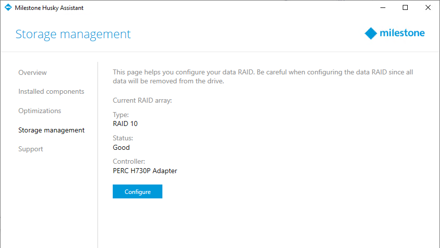

Storage management
On the Storage management tab, you can see the RAID type and status of the current data storage RAID array.
You can also change the RAID type to fit your storage needs for capacity, redundancy, and performance.
Check RAID status
To check the type and status of the data RAID configuration:
  1. Select the Storage management tab.
  2. The type and status of the current RAID array appears. The different types and statuses are:
    Type Description
    RAID 10 For best performance and most redundancy
    RAID 6 For high capacity and more redundancy
    RAID 5 For maximum capacity
    Status Description
    Good Normal working state
    Degraded The RAID is missing a hard drive, but it is still available
    Replace one or more hard drives. See Identify and replace a hard drive
    Offline Too many hard drives are missing from the RAID array, so the raid is now unavailable or offline.
    Not Configured No RAID is configured
    Unsupported A RAID configuration other than RAID 5, RAID 6, or RAID 10 is in use
    Unknown The status of the RAID array could not be detected

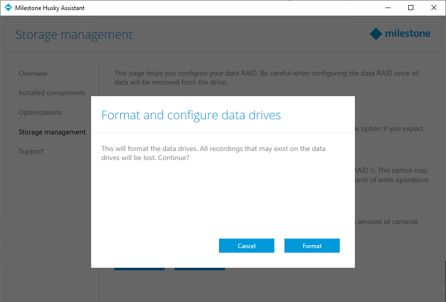

Change RAID type
To change the RAID array type:
  1. Check if the current RAID array status is Good and click Configure.
  2. Accept any user account control warning and click Next.
  3. Select the type of RAID that you would like to configure for data storage and click Apply.
    Read the warning stating that all data will be deleted if you continue. Your XProtect system records no video during the configuration.
  4. Click Format to accept the data deletion and start the configuration of the data RAID storage.
  5. A summary window of the RAID configuration appears. Check the type and status of your current RAID array.
Support
If you have a problem and need support, contact your Milestone reseller that you bought the unit from.

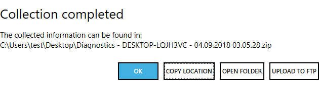

Create a diagnostics file
To help your Milestone reseller get logs and details about your system, create a Milestone diagnostics .zip file that lists the system information:
  1. Select the Support tab.
  2. Click Milestone Diagnostics Tool.
  3. Accept any user account control warning. The Main Page appears.
  4. Click the Collect Defaults icon to start creating a diagnostics .zip file.
  5. When finished, the diagnostics .zip file is saved on the Windows desktop. You can now move or transfer the file to any preferred location.
  6. Close Milestone Diagnostics Tool.
  7. Provide your Milestone reseller with the diagnostics .zip file when they assist you in troubleshooting a problem.
