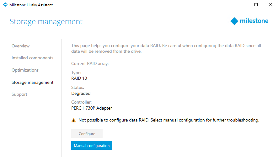

Identify and replace a hard drive
If the RAID array status is Degraded in Husky AssistantStorage management tab, this article will help you identify a faulty hard drive and rebuild the RAID configuration of your data storage.
If one of the hard drives fails, an audible alarm starts. After replacement of a faulty hard drive, you have to manually start the rebuilding of the RAID.

To make the replaced hard drive available for the RAID array, rebuild the RAID:
Click Manual configuration to open MegaRAID Storage Manager.
