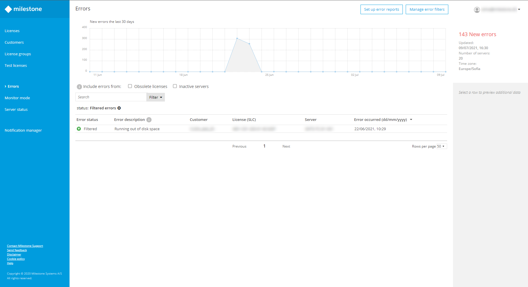

You can see all filtered errors by selecting Filtered status in the Filter (see Search for errors ).

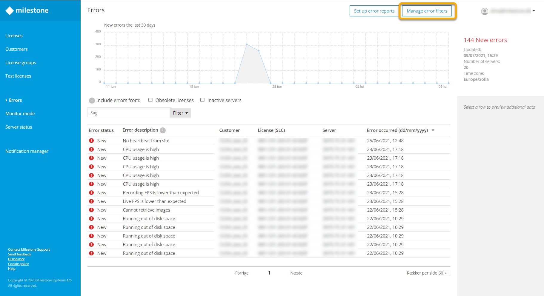

Create error filters for a customer
For each customer, you can specify which errors are displayed in the Errors page.
  1. Select Errors in the main menu, then select Manage error filters.
    The created error filters for your customers will be displayed on the Manage error filters screen.
  2. Select Create filter.

You can see all filtered errors by selecting Filter > Filtered Errors from the Errors page.

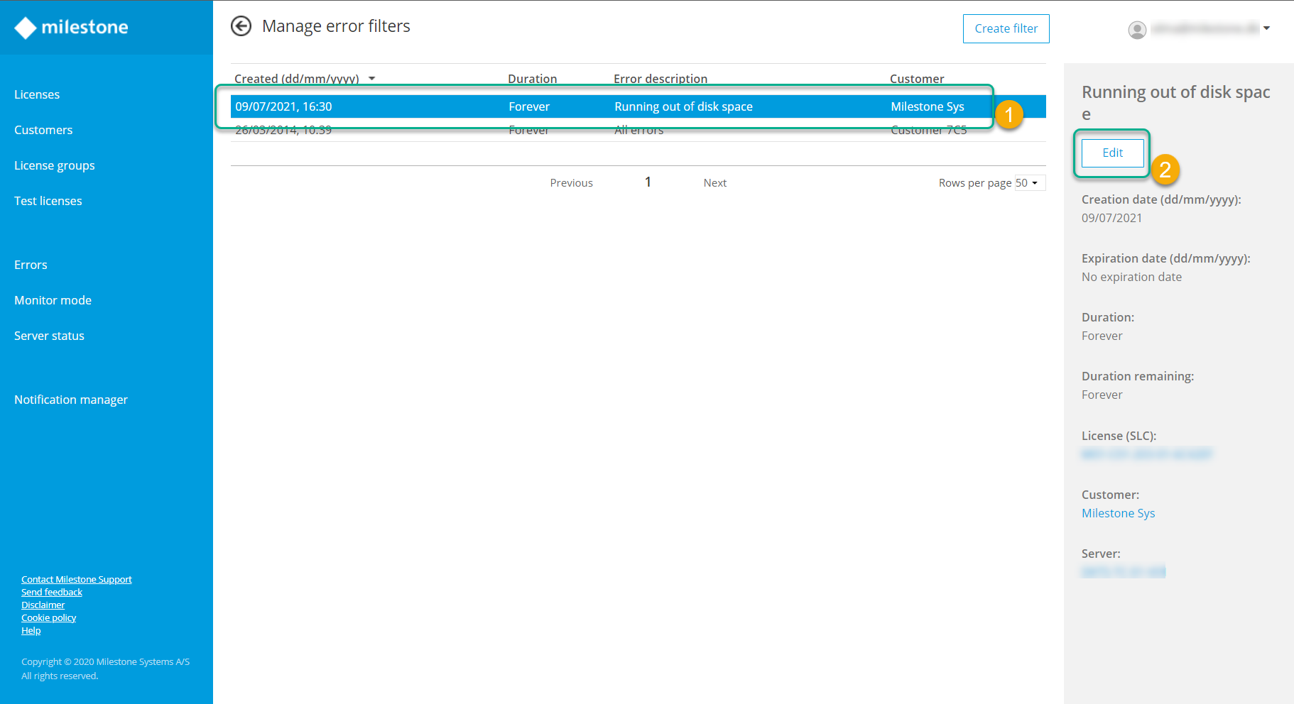

Edit error filters
With error filters, you can customize the errors you see in the Errors page. You can modify the existing filters, depending on your current needs.
To edit a filter:
  1. In the navigation pane, select Errors and then click Manage error filters.
  2. Select an existing filter and click Edit.
  3. In the Edit filter window, you can change some of the properties. After applying your changes, click Save. For more information, see Error filter (properties).
Delete error filters
With error filters, you can customize the errors you see in the Errors page. If you no longer need to filter specific errors, you can delete the error filter.

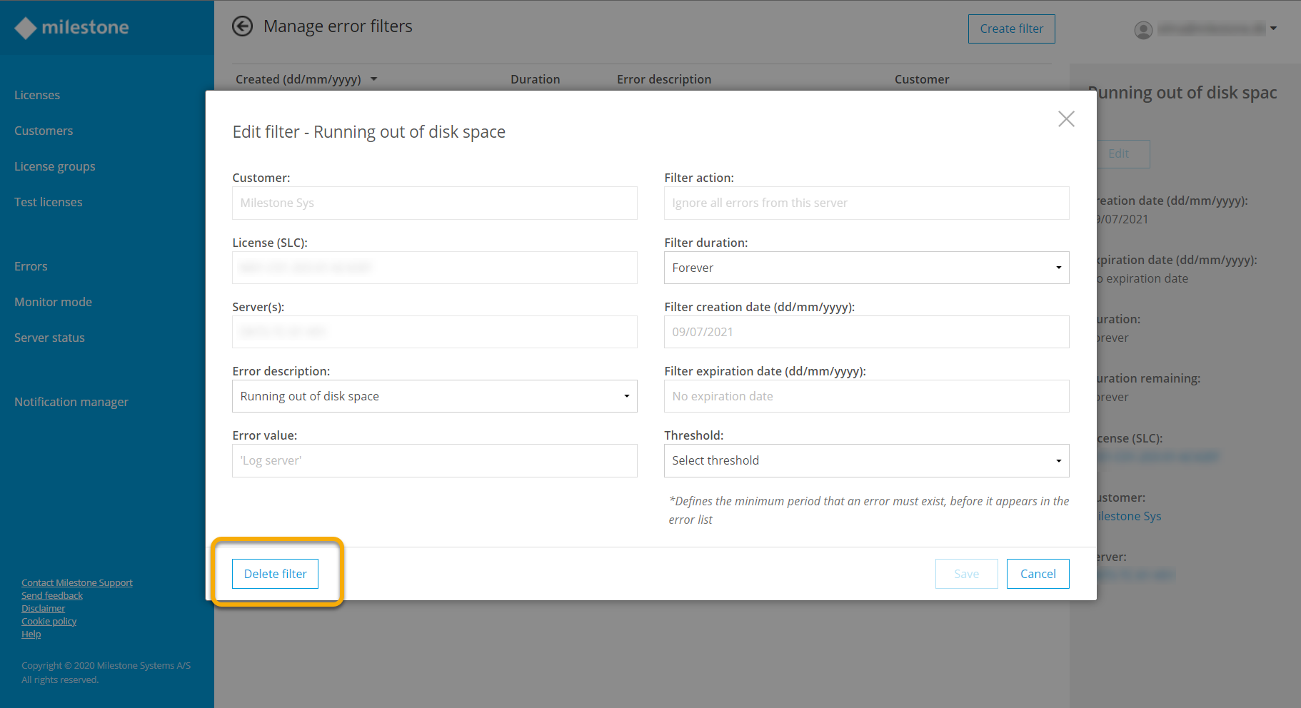

To delete a filter:
  1. In the navigation pane, select Errors, then click Manage error filters.
  3. Select Delete filter.
The error filter is removed and cannot be restored.
